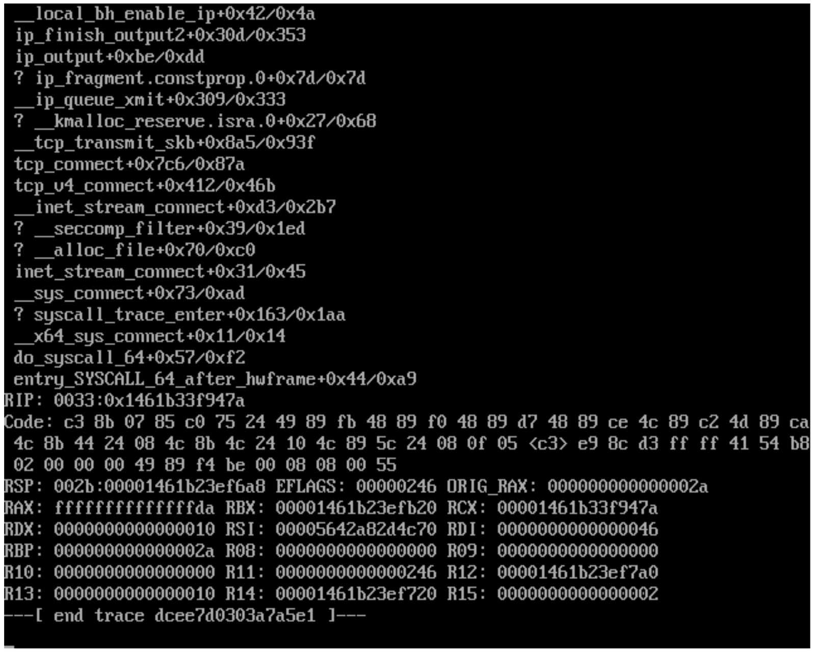

This is a screenshot as well that I grabbed from the KVM interface. Unfortunately I'm running issues trying to run the damn IPMI software so I can actually see the screen, but the screenshot at least shows some of the details.
