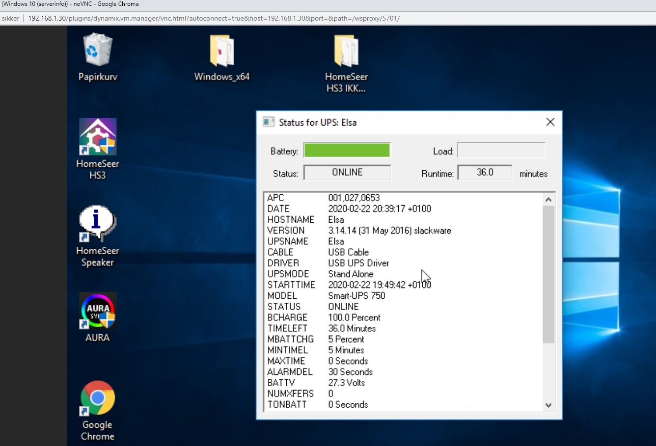

Unraid on UPS (USB) and apcupsd on VM for shutdown. How get this to work?
Hey! :)
apcupsd get info from unraid ups: (look in picture) (Use my network ip)
But how I get det VM to shutdown 1 min befor unraid do it?

Thx! :) How do I " set the VM to shutdown after 4 minutes (TIMEOUT 240) on battery." ? Cant find any settings on this program for it, just info fraom UPS:/

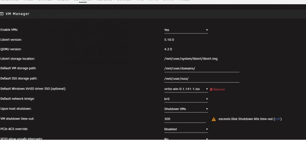

Yes, I drive HS3 and this app is very slow to shutdown. So i need more time for VM to shutdown. or my DB be lost.
How do I can get more time for VM to shutdown? Or wait to it shutdowan or if time get over 5-10 min, it can kill the VM for shutdown the unraid server :)

I change to 300. But what is? "exceeds Disk Shutdown 60s time-out (edit)" ? What do i change here?
Are you trying to do what I'm suggesting, because you keep quoting me, but your posting implies that you're attempting to work with @jonathanm  Very confusing on my part
For the immediate question, have you clicked the link there yet?  It'll take you directly to where you need to be.

How I can do this: "set unRaid to hibernate the VMs when it shuts itself down." Any guide on this here?
Switch where it says Upon Host Shutdown to be Hibernate, and on the VFIO ISO disk that appears in Windows you need to install the Client Tools.
