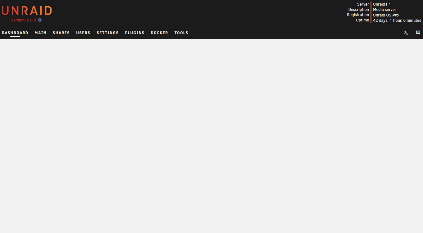

Up front, I am an Unraid novice and my build is relatively new.
My server is accessible via the web GUI, I can access/modify files, my dockers (Plex, Deluge, etc) are working fine, but multiple things are not working.
Problems I am seeing:
  • My dashboard is blank (all other tabs seem fine)
  • I can't update my dockers
  • I can't get my diagnostics via the GUI (I click download and it goes to a blank page) or the CLI (error below)
My searching turned up nothing, so I'm hoping for some guidance here.  My instinct is to reboot the system and hope it clears itself, but this seems semi-serious.
