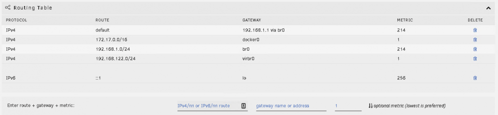

Yes, I know, this was asked once, and this was answered once. But I can't make it work. I attached my Routing Table below. VM is set to work with vibr0 as suggested in other threads, and it is getting the IP it's supposed to get (192.168.122.x). I think it's bridged over unRaid (br0) own network, since it's not showing up anymore on my router (it was set to work with br0 before).

Is there a easy way to isolate a VM from my network, but keeping it accessing the internet? I'm not that savvy in Linux. Is there a way to set it under the Routing Table settings?
Does your router support VLANs? if so, you can setup a VLAN, assign it to a port and plug Unraid eth1 to that. Make sure eth1 is not part of br0 though. Then just connect the VM to eth1(br1). Don't bother asigning an IP to eth1. Finally firewall off the VLAN from accessing the rest of the LAN and vice versa at the router.
Other option: get a cheap router. plug it into the main router. make sure they don't have the same subnet address. plug unraid eth1 to the 2nd router. (same as above make sure that eth1 is not part of br0, etc.) This will create a double NAT situation (like CGNAT for ISPs), which will prevent the LAN from accessing the VM, but the VM can access the LAN and the internet. But this will break stuff like dynamic port forwarding. and nothing on the internet can ever directly raech stuff on the VM. To port forward, you would need to manually configure router1 and router2.
