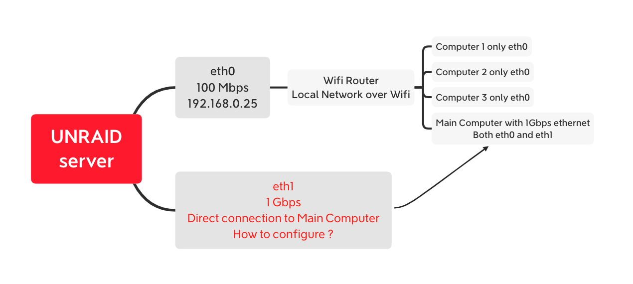

Here a schematic if it can be more clear with it.

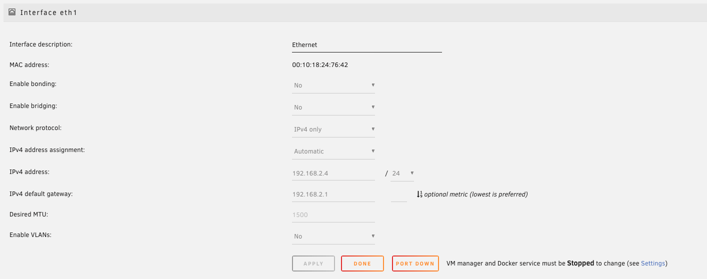

The simple way was set the 1Gbps path in different subnet IP,  thats all.
i.e. 192.168.1.25 / 24 if 100M path also 24.
Edited by Benson

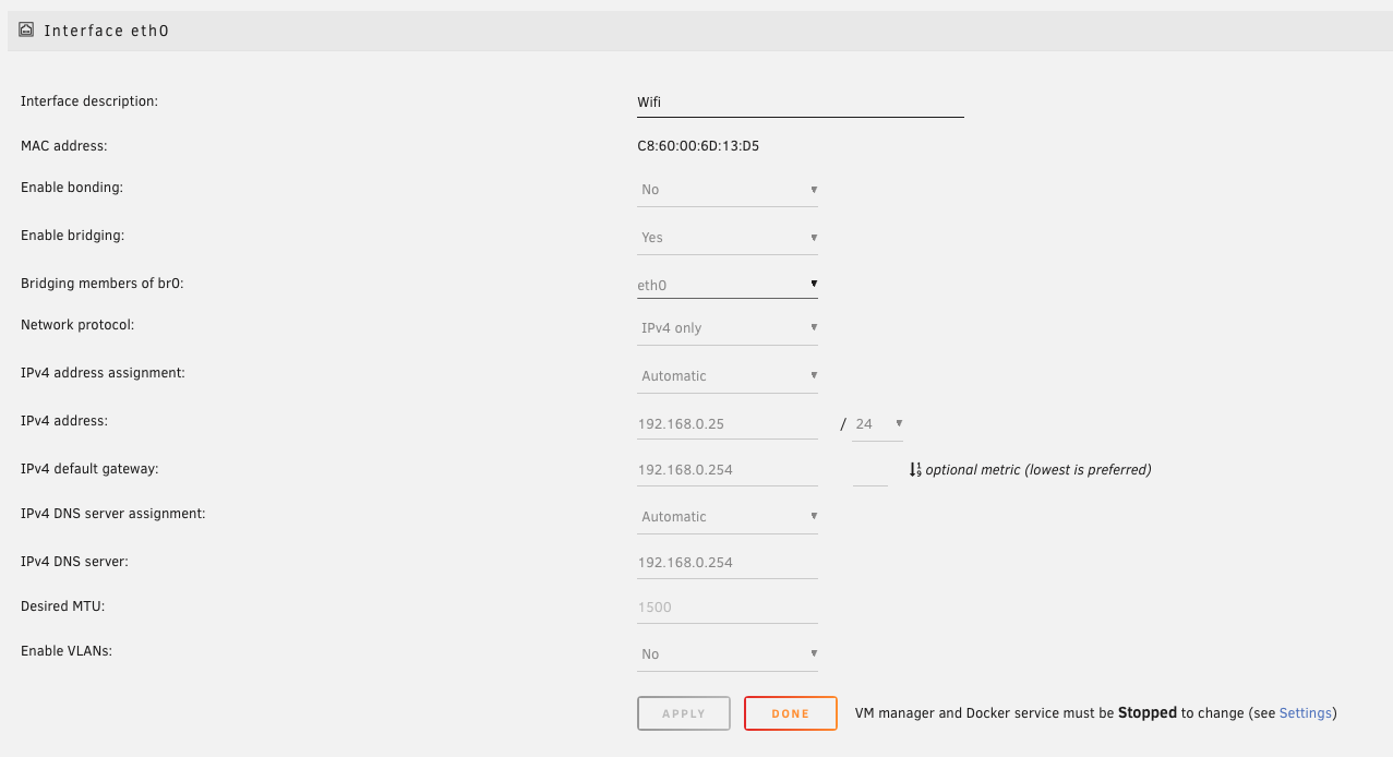

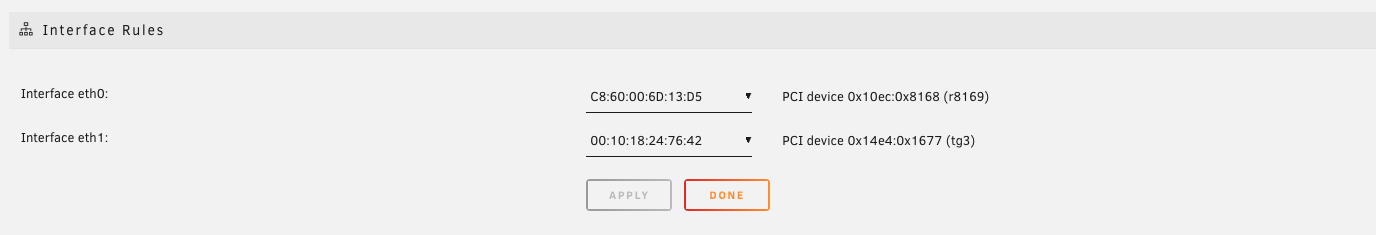

Hello Benson,
That is what i ended to do, with Automatic configuration :
(I try to put it on 192.168.1.1 / 24 and 192.168.1.2 for the gateway but not working, mystery as the ips seem free)
485516056_Capturedecran2020-03-15a14_12_26.thumb.png.c63544975ff33191408f3faab24cadaa.png
335939293_Capturedecran2020-03-15a14_12_35.thumb.png.91cf65f257d3b857534eb46a6d389e24.png
2086751006_Capturedecran2020-03-15a14_12_47.thumb.png.48913c25b56dcfc865f72e48e8c1c28e.png

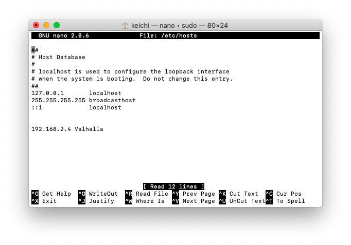

And i add a local domain in /etc/hosts to avoid the crappy "192.168.2.4" in the Finder of macOS :
As it is not in the same subnet, i create an auto-mount on startup because i can't see it in "Network" tab. Don't know if there is a simple way to do that....
