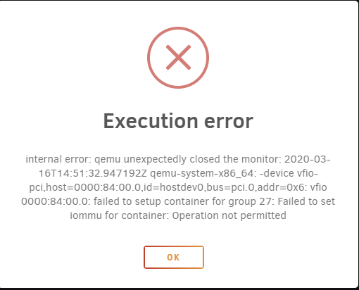

Hey everyone!  I followed SpaceInvaderOne's youtube guide for passing through a PCI-E USB3.0 controller I put into my unRAID server.  When I go to start the VM, I get the following error:

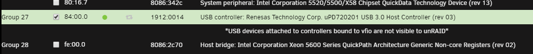

Followed the guide, see it in my pass through:
Check the box, save the settings.  Try to start the VM and get the following:

Install the "VFIO-PCI CFG" plugin and check that card and any other cards, including video cards, you want to pass through to your VM's.
Thanks.  Did that.  It added 84:00.0 to the config.  I rebooted, checked the box to pass through to the VM, same error as above.  Do I need to remove the vfio-pci.ids=1912:0014 from my boot config?

Yes, the vfio-pci.cfg is the preferred method of specifying which devices with which you want to do pass-through.

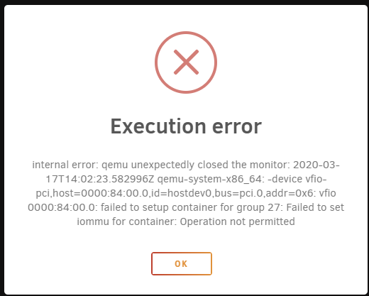

OK - came back this morning, rebooted after removing the append part.  VM settings sees the USB card, but when i check the box and click update to update the VM settings, they save.  When I go to start  the VM, get this:
Nothing else is in group 27 (checking via command line and via the plugin):
