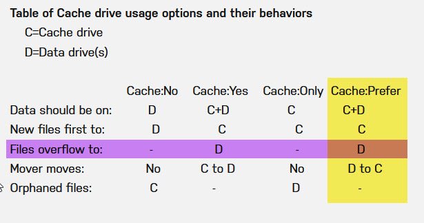

Question 1:
How to make: Backup downloads shared folder to be shown available at:
Cache + Array, using the Prefer method?
Question 2:
If I am using "Prefer" method, what is going to happen to Cache when its capacity
is full? Referring to the diagram above, I understood it will overflow to the Array.
Meaning my data will be split up storing in the Cache and Array? Right?

Depends upon how you're looking at it.  If surfing around via the array devices and exploring each individual disk, then no you wouldn't find it, because it exists on the cache drive only at the moment (because it "prefers" to be on the cache drive and will only use the array as a fall back if the cache gets full).  It IS still completely available over the network and will contain any and all files whether they are located on the cache drive or on an array disk
On 3/21/2020 at 11:46 AM, wepee said:
Question 2:
Yes
You might be completely over thinking things.  For speed and stuff that isn't particularly important or temporary (like downloads), you would tend to set them to be cache:Prefer
For regular stuff you set it to either cache:No or cache:Yes
Regardless of where anything is physically stored (cache or array), it is always available on the "array".  IE: navigating through your shares on a Windows box will show all the files, whether or not they are on the cache drive or the array (or a combination)
Telling something like Plex to find your media files at /mnt/user/ShareName will find all your files regardless of whether or not they are on the array or the cache drive.
