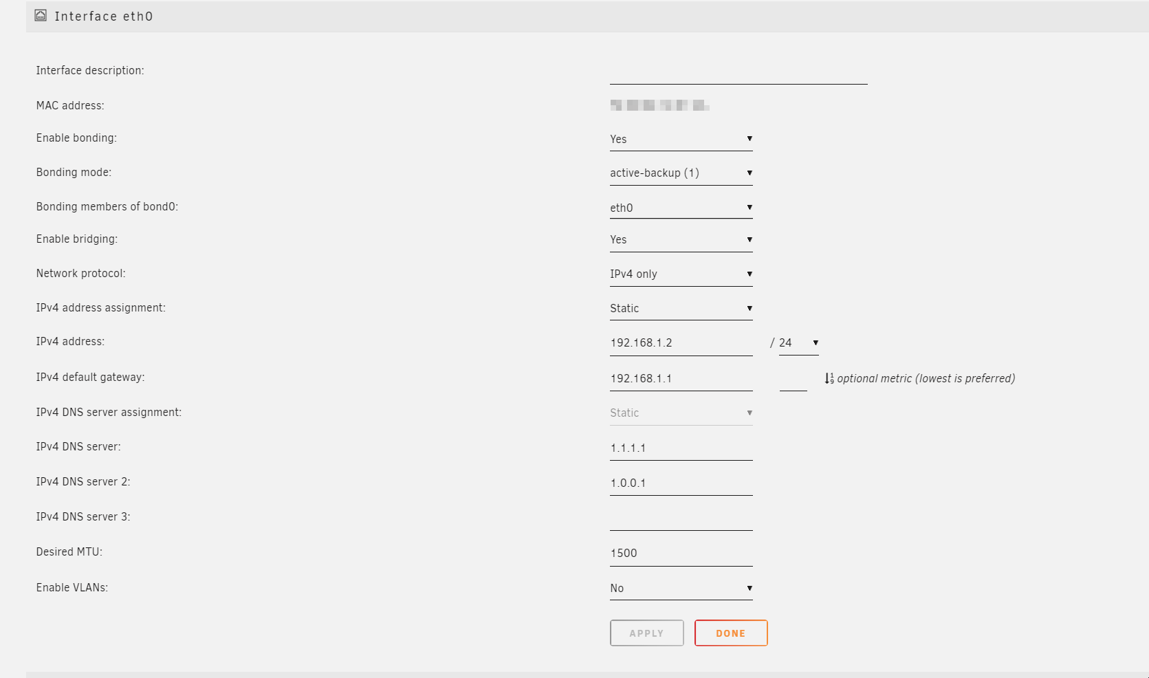

It's been a while I had power off one of my unraid server. From version 6 something had to do manual update to latest version but still no internet access.
Everything else seems to work fine. I have read various posts with similar issue. I have installed another license on a hp microserver, so clean install with same settings - network and works works.
Maybe something is left from past upgrades?
I would really appreciate some help......

Try deleting or renaming config/network.cfg on flash and reboot so it will use default network settings.

Those are not the default network settings. Are you sure you renamed the correct file?
When I renamed the file. I could not open unraid.
Just for test since I use usb card reader I tried a fresh install on another card, same thing. No internet
I attach the file from the fresh installation also.
I have put back the sd card with my config. I have physical access or even with telnet. Is there a file or something I can check?

The default settings for network use DHCP. Possibly that would result in a different IP than you were trying. If you have an attached monitor and keyboard you can see what IP results from the default network settings.
