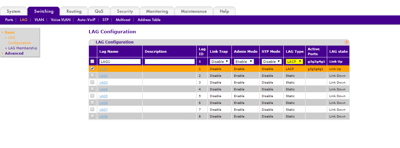

I have recently acquired a Negear GS748Tv4 switch which has Link Aggregation capability. I have frequently considered this in a constant pursuit to optimize my configuration and see how different technologies work.
I have discovered with my Bond, I can switch it to option 4 (802.4ad) which seems to be meant to compliment the Link Aggregation technology in my Negear switch. However, when I have all 4 of my ports bonded on the Unraid server, and I turn on Link Aggregation in the switch on the ports the Unraid server connect to, I Lose connectivity. Once I disable LAG again, I restore connectivity.

I may have just answered my own question. It seems that the switch needed to be configured in with LACP rather than a static LAG. Currently everything seems to be running as expected. I am going to reboot my switch to be sure.

The solution it seems was that I required the LAG to be switched to the LACP standard. The key was the 802.4ad designation in the bond driver from within Unraid.

Both the switch and Unraid must be configured with the 802.3ad standard in order for LAG to work. From within the netgear switch I describe, you must select the Lag which will allow you to change from Static to LACP. This will allow your Netgear switch to use your Unraid LAG.
I am putting this solution and screenshot here for anyone else that may run into a similar issue.
