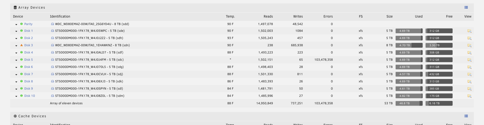

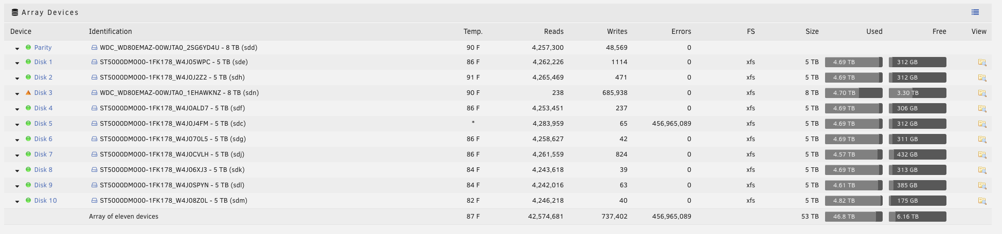

Now that that's out of the way. I had a data disk go bad in my array, I got a new drive put in mid-day yesterday and then right before I went to sleep I checked the progress one last time and saw this (first image). I knew I was screwed but couldn't deal with it last night. This morning it looks like this (second image).
I'm not going to beg for ways to save the data (I understand it's gone). What I want to do is stem the tide of damage. Should I kill the rebuild and just write off 10TB (old drive was 5TB that I replaced)? How can I do that while saving the remaining data? Again, I know this is my own fault and I've lost a good chunk of data but I would really appreciate any help in saving whatever I can.

Well I was going to attach them but it's been working on it for 20min now, I'm going to leave the page open but should I expect it to ever finish?
Also here is an update on the rebuild process
Total size: 8 TB
Elapsed time: 20 hours, 21 minutes
Current position: 2.20 TB (27.5 %)
Estimated speed: 398.3 KB/sec
Estimated finish: 168 days, 13 hours, 21 minutes

May not be as bad as you think. Best case, you disturbed the connection to disk5 when replacing disk3, and fixing that before restarting the rebuild will result in complete success. Might even be possible that the disk you replaced wasn't bad either but something else caused it to be disabled.
Or it could indeed be bad due to all the neglect, though it would be unlikely to lose more than just that 1 or 2 disks.
We won't know without more information than just those screenshots. Absolutely no point in continuing with that rebuild with all of the disk5 errors. Stop it and see if you can get diagnostics.
The rebuild should be canceled, but there's a change data can be salvaged, disk5 might have dropped offline.
Power down, check/replace cables on disk5, power back on and post diags.
