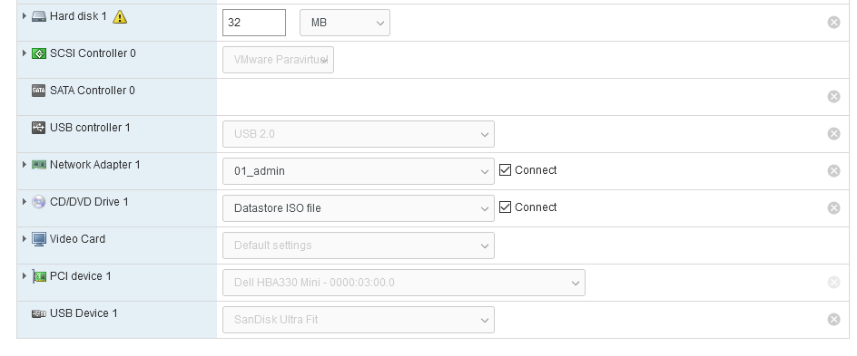

Would you please share how you have the VM set up?  I tried this over the weekend with ESXi 7 and couldn't get the VM to boot from the USB stick.

10 minutes ago, Adam64 said:
I was never able to get the VM to see the USB stick.  Neither native nor with plopexec.

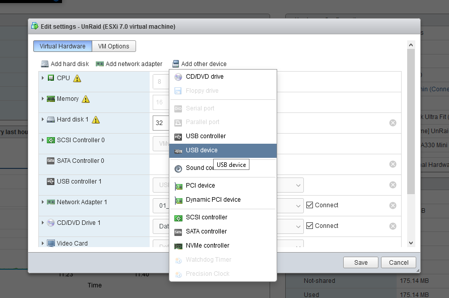

ESXI is fussy with what USB drives you use. I failed to install it twice with older drives.
Try adding it this way if you haven't already.
Here's what you want to pick up:
https://www.amazon.com/dp/B077Y149DL/ref=twister_B078VKF48F?_encoding=UTF8&psc=1
Edited by bmilcs

Thanks.  Someone in another thread said he'd fixed his boot from USB issues by changing his USB controller to 3.0.
I have passed thru my USB, and boot directly from it.  You do need to enable EFI boot to do that.
