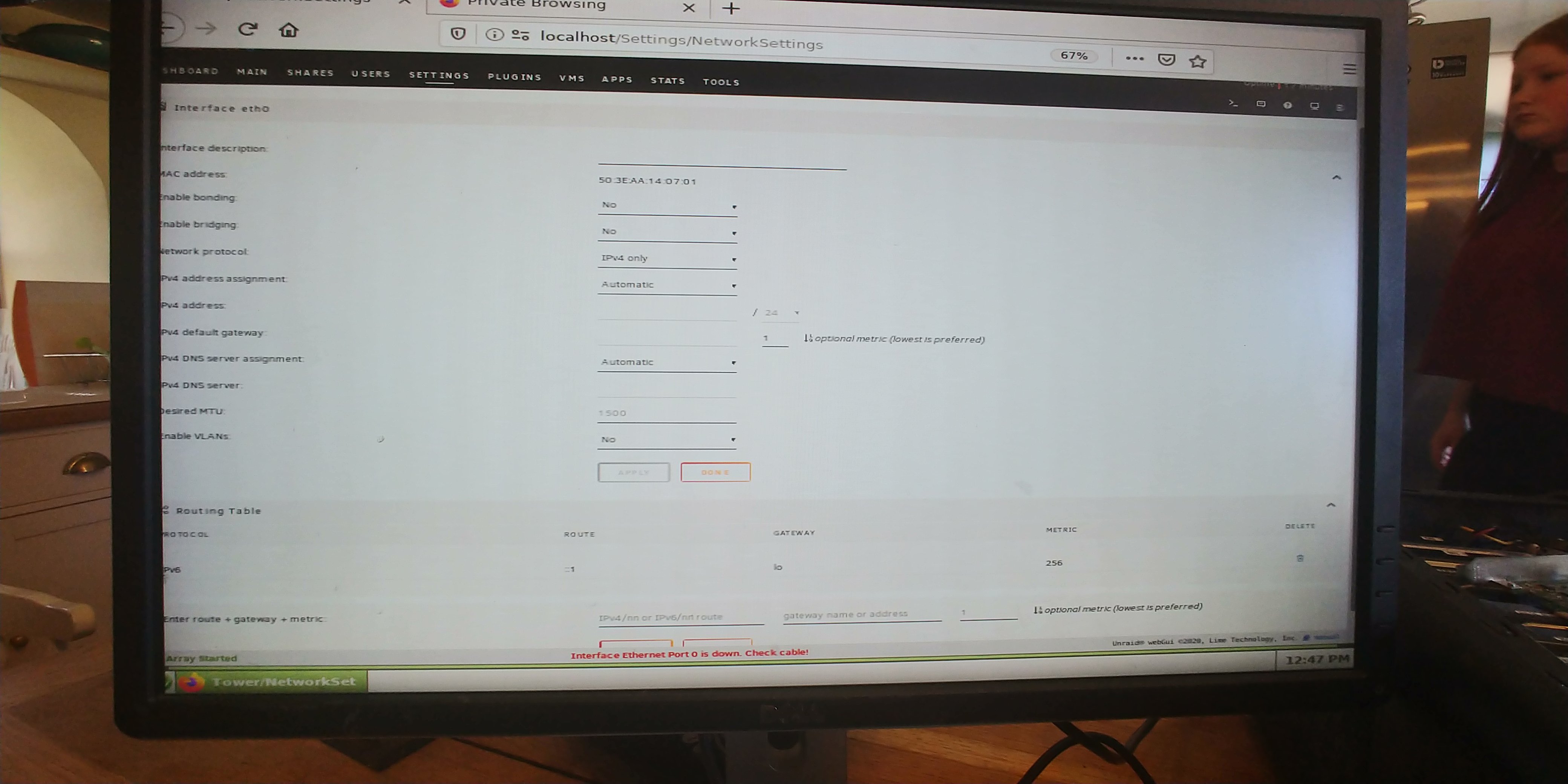

yes - booting with GUI mode. Actually, I have now disabled the onboard NIC to reduce wiggle room. Here is the screenshot of my network settings now. I should have mentioned that I am on unraid version 6.8.2
I'll re-download the diagnostics file in a moment and post in next few minutes.
Don't know why but it's still renaming eth0 to eth1, leaving you without eth0 which is needed, see if it's the same with an older release, like 6.7.3, delete network.cfg before doing it.
