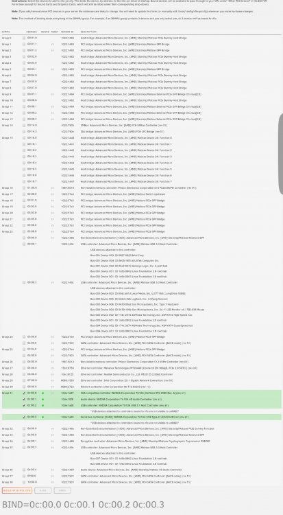

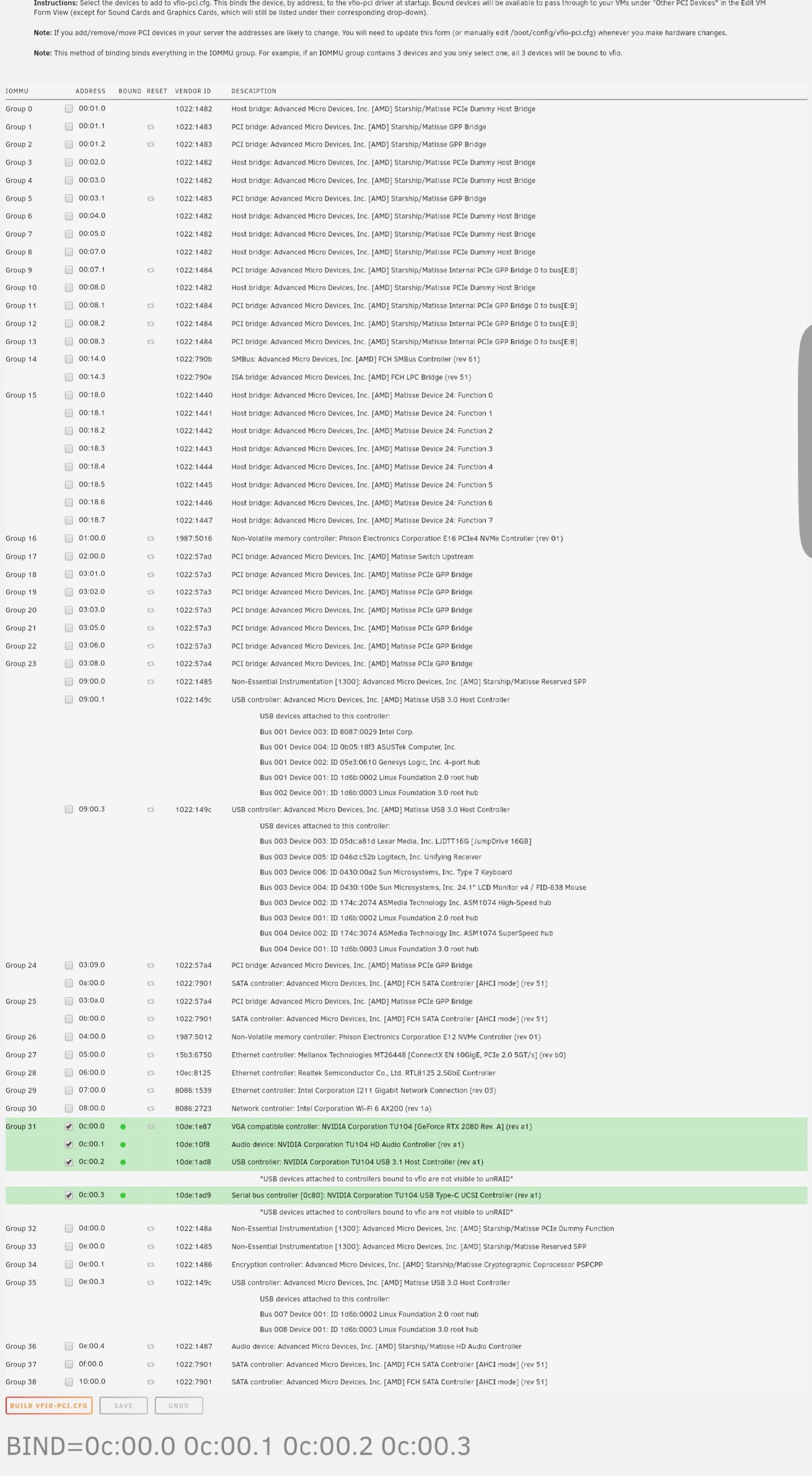

For unRAID boot menu entry, I have:
kernel /bzimage
append video=efifb:off initrd=/bzroot
With VFIO-PCI, I'm currently just passing through the GPU with:
BIND=0c:00.0 0c:00.1 0c:00.2 0c:00.3
Output from plugin is as follows:

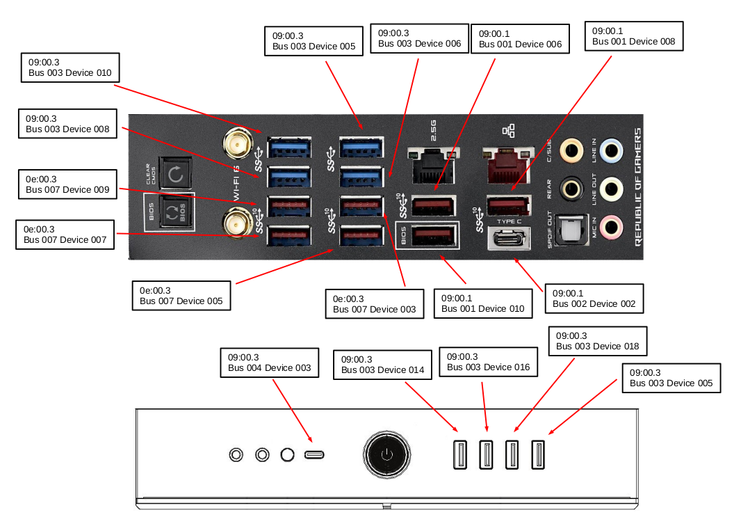

I've mapped out the USB ports, and they look like this:

Just a quick message to say that I've solved the problem now. Mapping out the USB ports helped me a lot.
I've now moved the unRAID USB stick to the 0e:00 USB controller, and am now able to passthrough both USB controllers on 09:00.

can you send a screenshot of your VFIO-PCI Config to know what usb do you passthrough. Thank you very much.
