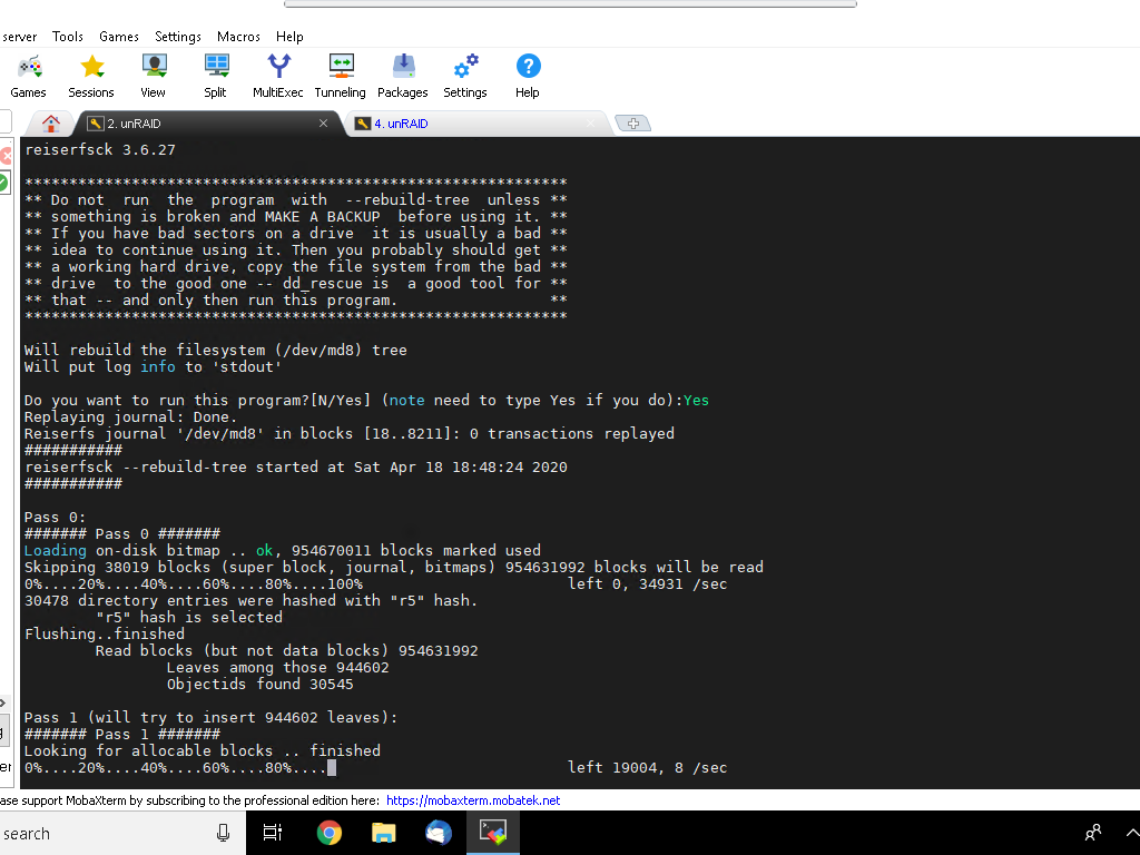

So I'm running a --rebuild-tree on two data disks.
Just wondering if anyone knows why it always sloooooooooows to a crawl at the end?

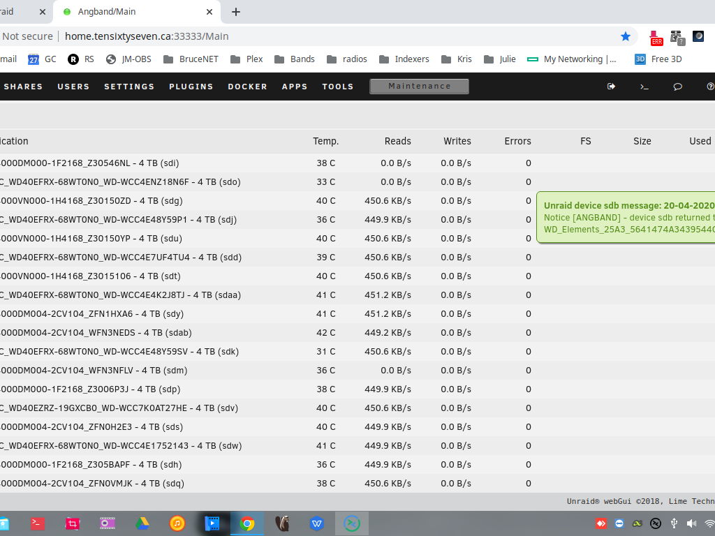

There are no errors in the log, the /s rating just drops. It starts at 36/s or so in stage two and then drops to 8/s (see image).
There is, obviously disk activity in the GUI but it's taking DAYS to complete the check - during which users get upset because the shares are offline.

There have been reports of taking days even after it's done, in the syncing stage, would recommend converting any reiserfs drives ASAP, it's not a recommended fs for many years now..
