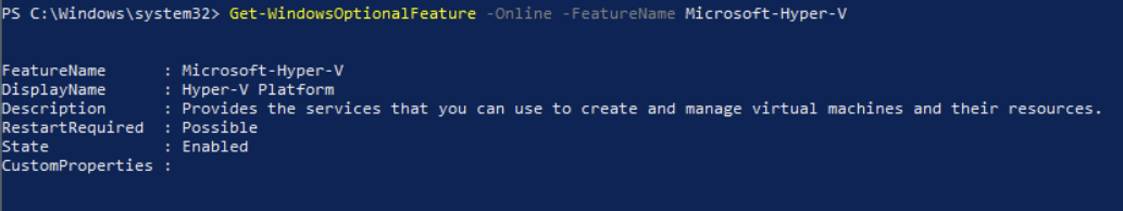

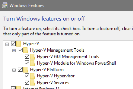

I could enable hyper-v features in W10 VM and as far as I can determine they should be working:

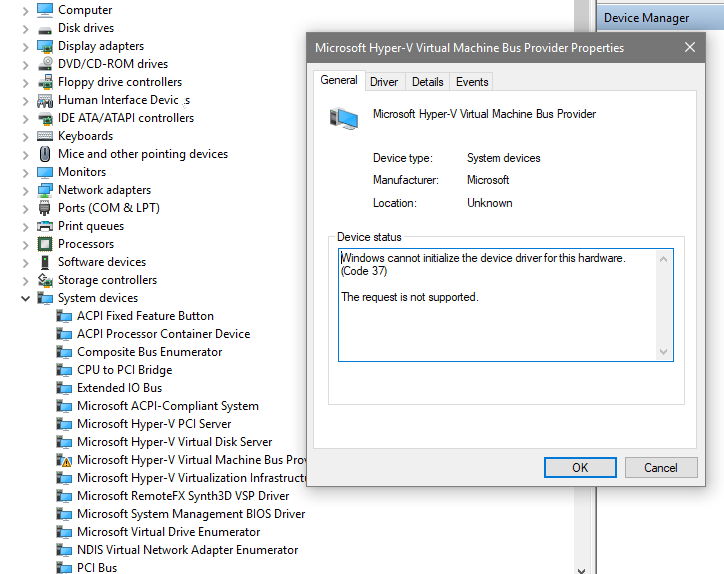

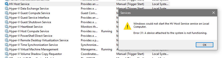

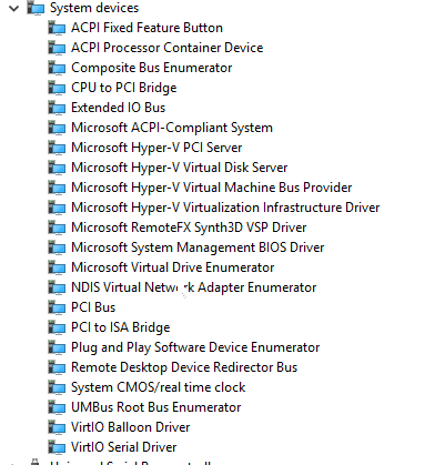

I am assuming it is because one of the hyper-v services is not running and won't start (in a physical machine with docker working, it is running) :
I also assumed the service issue was caused by this driver problem:
I have retried disabling-enabling features and reinstalling docker desktop with same end result.

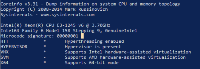

<feature policy='disable' name='hypervisor'/>
Which resulted in W10 not being aware that it is a VM:
"Virtualization: Enabled" seemed lika good thing and it also seemingly fixed the driver issue:
But the HV Host Service behaves still in the exact same manner (so maybe this driver thingy is not relevant at all?)

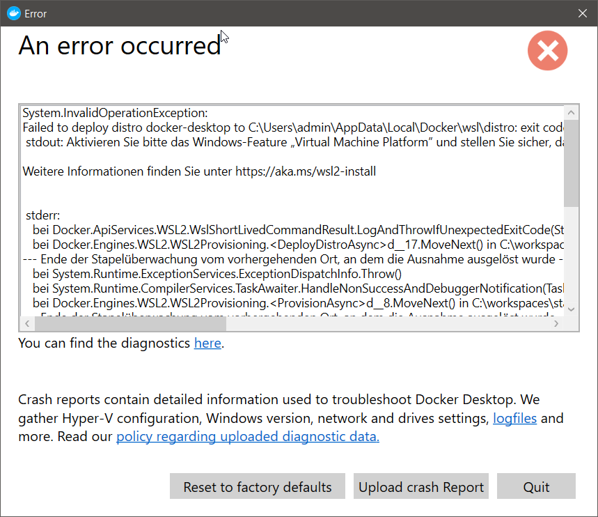

Having the same problem trying to start Docker with WSL2 backend inside a Win10 VM with passed through NVidia GPU (if that's relevant). The VM is running off of a bare metal install of Windows 10 on a passed through HDD (when booting directly into that Windows it works).
System.InvalidOperationException:
Failed to deploy distro docker-desktop to C:\Users\admin\AppData\Local\Docker\wsl\distro: exit code: -1
 stdout: Aktivieren Sie bitte das Windows-Feature „Virtual Machine Platform” und stellen Sie sicher, dass die Virtualisierung im BIOS aktiviert ist.
Weitere Informationen finden Sie unter https://aka.ms/wsl2-install
 stderr:
   bei Docker.ApiServices.WSL2.WslShortLivedCommandResult.LogAndThrowIfUnexpectedExitCode(String prefix, ILogger log, Int32 expectedExitCode) in C:\workspaces\stable-2.5.x\src\github.com\docker\pinata\win\src\Docker.ApiServices\WSL2\WslCommand.cs:Zeile 146.
   bei Docker.Engines.WSL2.WSL2Provisioning.<DeployDistroAsync>d__17.MoveNext() in C:\workspaces\stable-2.5.x\src\github.com\docker\pinata\win\src\Docker.Desktop\Engines\WSL2\WSL2Provisioning.cs:Zeile 169.
--- Ende der Stapelüberwachung vom vorhergehenden Ort, an dem die Ausnahme ausgelöst wurde ---
   bei System.Runtime.ExceptionServices.ExceptionDispatchInfo.Throw()
   bei System.Runtime.CompilerServices.TaskAwaiter.HandleNonSuccessAndDebuggerNotification(Task task)
   bei Docker.Engines.WSL2.WSL2Provisioning.<ProvisionAsync>d__8.MoveNext() in C:\workspaces\stable-2.5.x\src\github.com\docker\pinata\win\src\Docker.Desktop\Engines\WSL2\WSL2Provisioning.cs:Zeile 78.
   bei Docker.Engines.WSL2.LinuxWSL2Engine.<DoStartAsync>d__25.MoveNext() in C:\workspaces\stable-2.5.x\src\github.com\docker\pinata\win\src\Docker.Desktop\Engines\WSL2\LinuxWSL2Engine.cs:Zeile 99.
   bei Docker.ApiServices.StateMachines.TaskExtensions.<WrapAsyncInCancellationException>d__0.MoveNext() in C:\workspaces\stable-2.5.x\src\github.com\docker\pinata\win\src\Docker.ApiServices\StateMachines\TaskExtensions.cs:Zeile 29.
   bei Docker.ApiServices.StateMachines.StartTransition.<DoRunAsync>d__5.MoveNext() in C:\workspaces\stable-2.5.x\src\github.com\docker\pinata\win\src\Docker.ApiServices\StateMachines\StartTransition.cs:Zeile 67.
   bei Docker.ApiServices.StateMachines.StartTransition.<DoRunAsync>d__5.MoveNext() in C:\workspaces\stable-2.5.x\src\github.com\docker\pinata\win\src\Docker.ApiServices\StateMachines\StartTransition.cs:Zeile 92.
If I disable the WSL2 backend, I don't get that error but Docker says "failed to start".

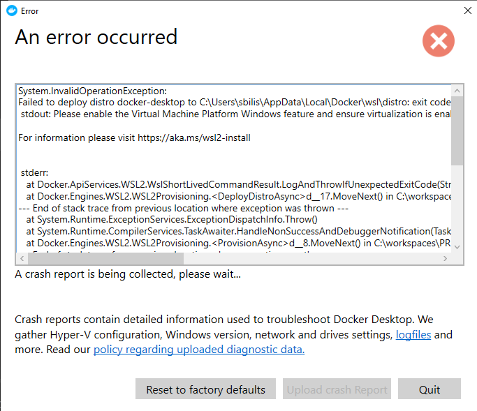

I have similar problem here like @nastard. When I start docker using windows-based containers within vm it starts no problem. When I start vm using linux based containers, the error that @nastard mentioned in previous post shows up. I checked that both VT-d in BIOS and virtual machine platform feature in windows vm are both enabled.
@testdasi Could you elaborate more to your solution with much detail into the steps you have followed?
Failed to deploy distro docker-desktop to C:\Users\sbilis\AppData\Local\Docker\wsl\distro: exit code: -1
 stdout: Please enable the Virtual Machine Platform Windows feature and ensure virtualization is enabled in the BIOS.
For information please visit https://aka.ms/wsl2-install

   at Docker.Engines.WSL2.WSL2Provisioning.<ProvisionAsync>d__8.MoveNext() in C:\workspaces\PR-15077\src\github.com\docker\pinata\win\src\Docker.Desktop\Engines\WSL2\WSL2Provisioning.cs:line 78
--- End of stack trace from previous location where exception was thrown ---
   at System.Runtime.ExceptionServices.ExceptionDispatchInfo.Throw()
   at System.Runtime.CompilerServices.TaskAwaiter.HandleNonSuccessAndDebuggerNotification(Task task)
   at Docker.Engines.WSL2.LinuxWSL2Engine.<DoStartAsync>d__25.MoveNext() in C:\workspaces\PR-15077\src\github.com\docker\pinata\win\src\Docker.Desktop\Engines\WSL2\LinuxWSL2Engine.cs:line 99
   at Docker.ApiServices.StateMachines.TaskExtensions.<WrapAsyncInCancellationException>d__0.MoveNext() in C:\workspaces\PR-15077\src\github.com\docker\pinata\win\src\Docker.ApiServices\StateMachines\TaskExtensions.cs:line 29
   at Docker.ApiServices.StateMachines.StartTransition.<DoRunAsync>d__5.MoveNext() in C:\workspaces\PR-15077\src\github.com\docker\pinata\win\src\Docker.ApiServices\StateMachines\StartTransition.cs:line 67
   at Docker.ApiServices.StateMachines.StartTransition.<DoRunAsync>d__5.MoveNext() in C:\workspaces\PR-15077\src\github.com\docker\pinata\win\src\Docker.ApiServices\StateMachines\StartTransition.cs:line 92
