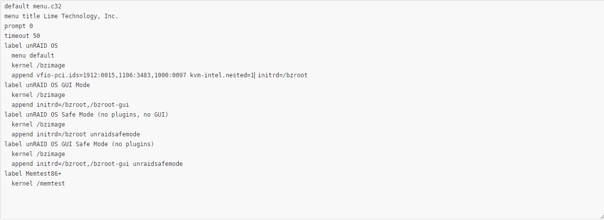

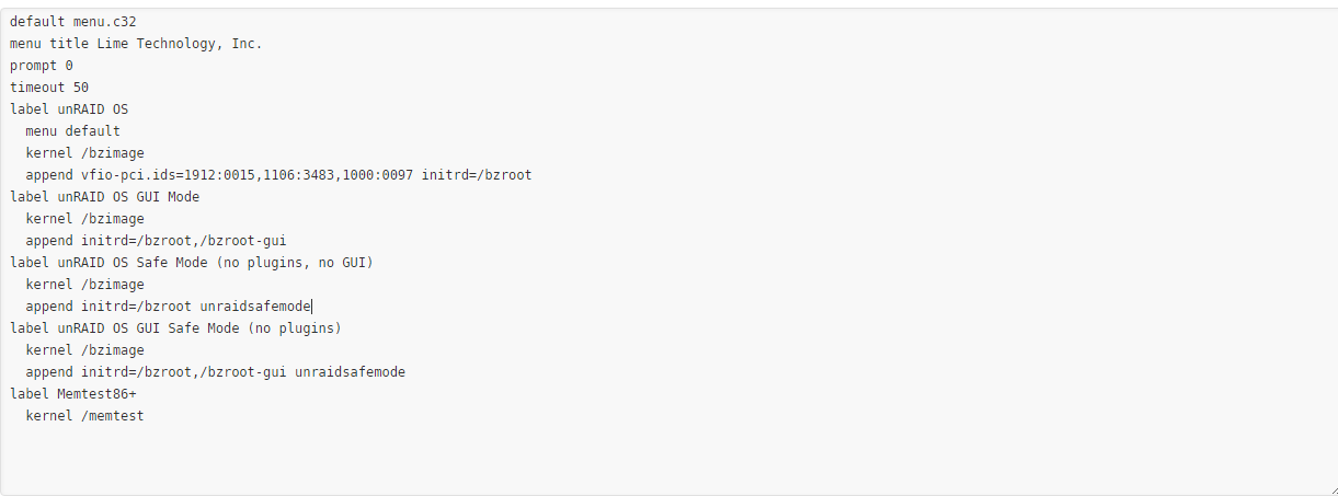

March 12, 20188 yr In this guide I will be tell you how to run Hardware accerated virturalization in Unraid VM Requirement Intel CPU that support vm-x NOTE : This won't work with Hyper-v on some case , I wouldn't try if I were you because if it fail It might corupt the vm ! First Go to Main Tab Click on The "Flash" text and an option to your sys linux Like the following BEFORE: AFTER: Reboot Then go to VM Tab and click on the vm you want to enable nested virturalization and click edit XML add <feature policy='require' name='vmx'/> and change model to custom like the following BEFORE: AFTER: click Apply Then Start, Done Edited March 12, 20188 yr by Siwat2545
