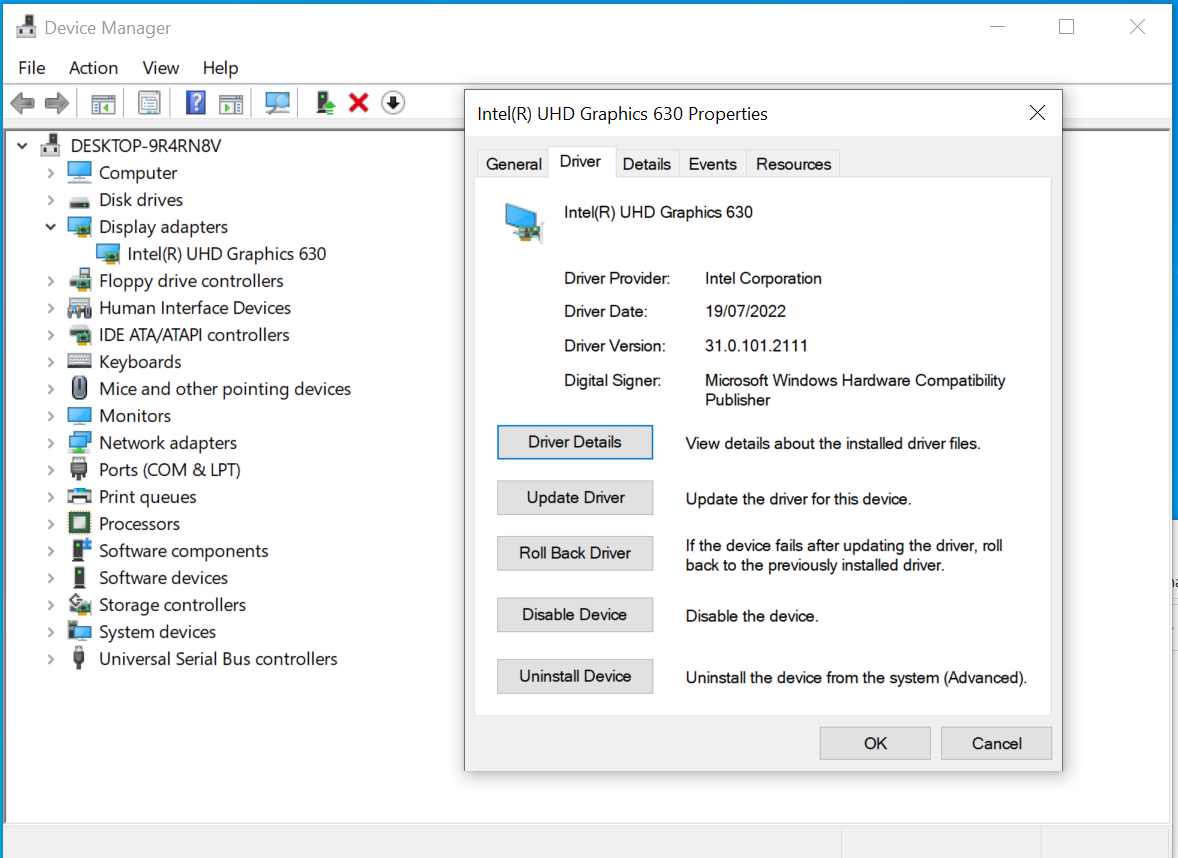

  1. Ok for the reference of people finding this at a later date (me). I have managed to get this working reliably in Seabios with: - Video=efifb:off in me bzimage / syslinux config - Use the HP driver (not generic Intel one) for UHD630 and it stops bluescreening each day. The attached image is a working driver version. Fingers crossed everything continue to work. thx all for your help.

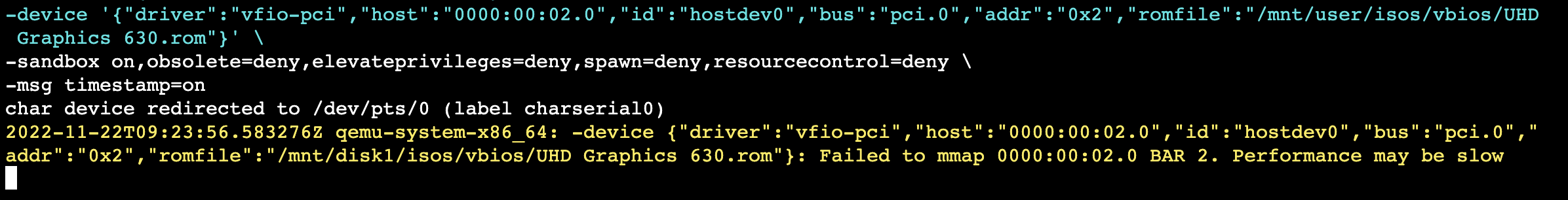

  5. Small update, I was able to get the "failed to mmap" error to dissapear with appending "video=efifb:off" in my syslinux config. Still no change to video output however.

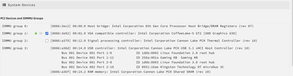

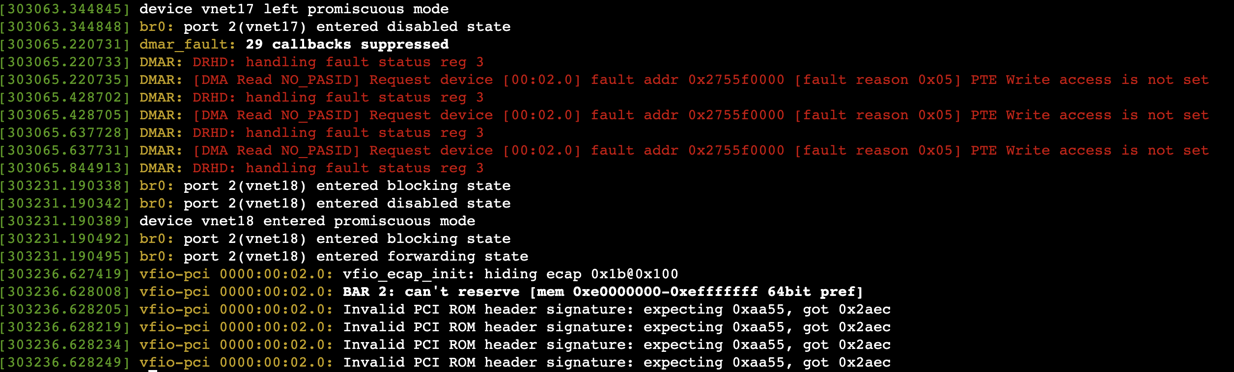

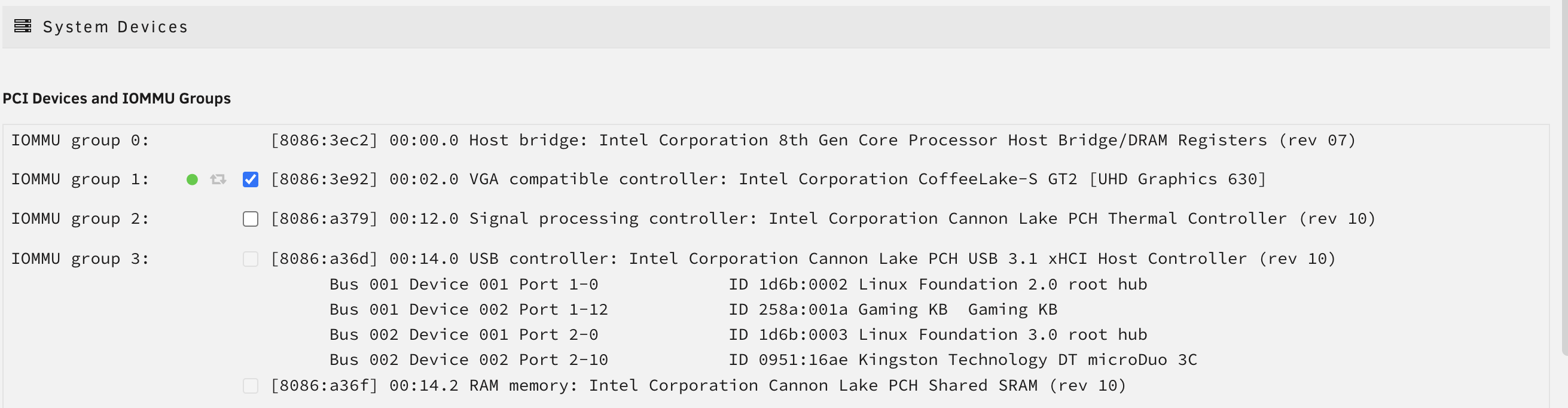

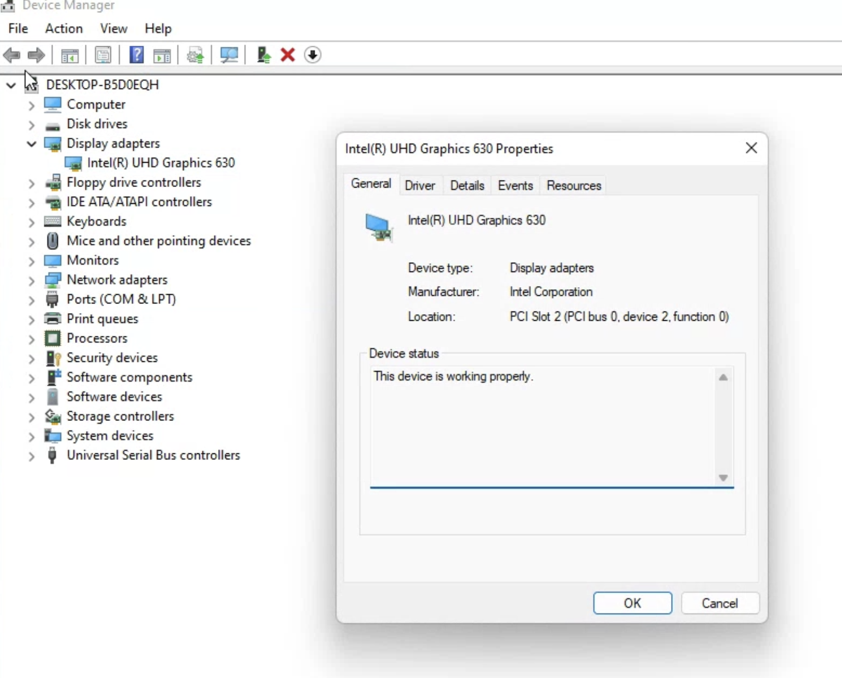

  7. Hi fellow Unraiders, I have a HP Mini (Prodesk 600) with Intel 8500t and UHD 630 graphics. The strangest thing is going on with the intel UHD garphics, I cannot get it to output in a Windows 11 VM, but works in Linux VM's. When i use remote desktop on windows I see the UHD630 is working according to windows, just no output. The logs on the windows machine show the following: ^^^ This error is in all VM logs, even linux when it's working. dmesg shows me a whole lot of this: GPU is also bound at boot via System Devices: I have tried: - Q35 & i440fx types - Windows 10 with seabios - Extracting the Rom (using spaceinvaderone's script, doesn't seem to work for this igpu) All of which dont work with a windows VM. Installed nobara (Fedora) and it outputs at the desktop everytime, no issues using OVMF. One thing is i never see the bootloader, just the desktop. Attached are my XML's for working Nobara and the above win 11 VM. Does anyone have any experience with the 630 or ideas ? Really at a loss.... 🤷 WindowsVM-notworking.xml linux-workingVM.xml
