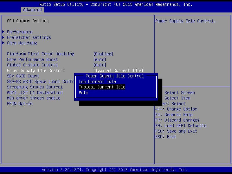

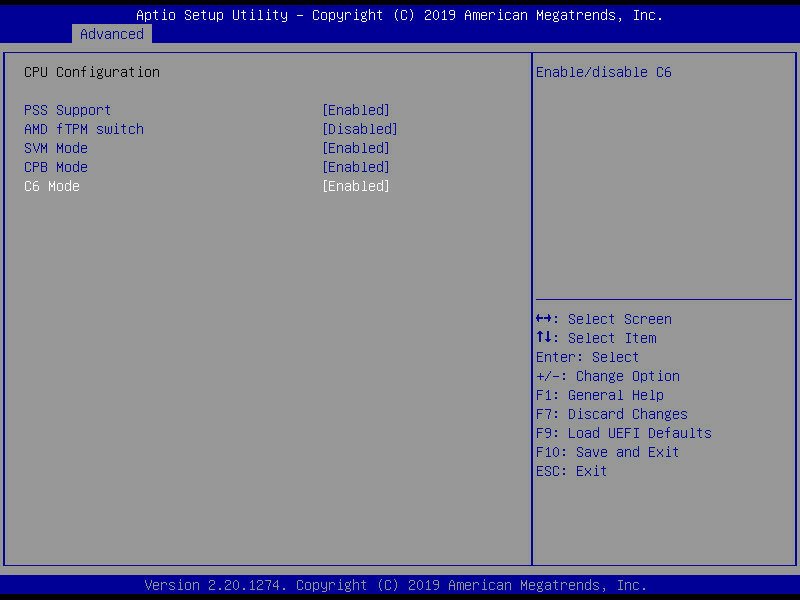

Thanks for the reply.
I allready did all things what mentioned in this thread.
  1. added rcu_nocbs=0-15 to the boot option.
  2. Bios: set Power Supply Idle Control to Typical
  3. Bios: C6 Enabled (there was some missleading comments at first, but i think turning off was not correct?)
  4. Latest Bios
So any other tips what i can do?
