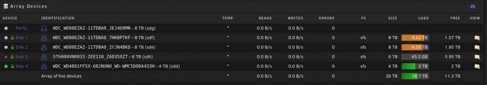

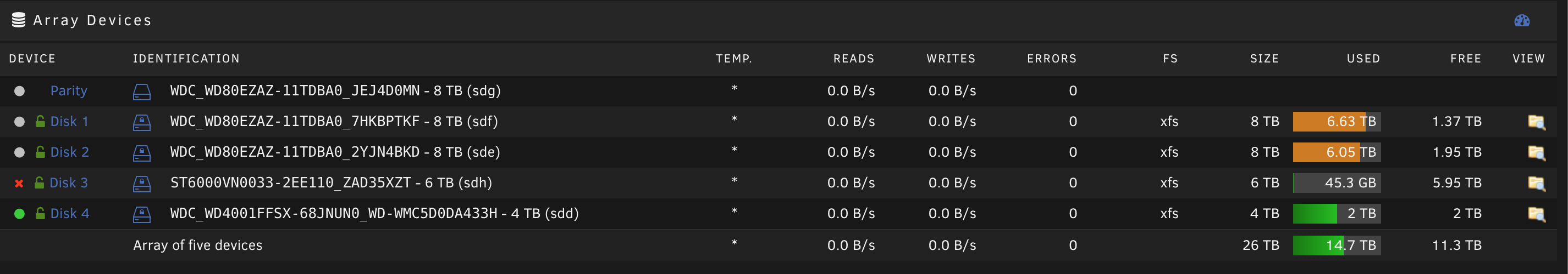

Thanks for your reply.
See attached the actual state.
It's still disabled, but accessable, but empty.
4TB are gone, but i think i got a backup of the most of the files, only the newest files should be missing.
Then i have to compare the incomplete shares with my backup shares.
But what to do with the disabled device?
It still shows up as disabled and some shares show that they are partly unprotected.
