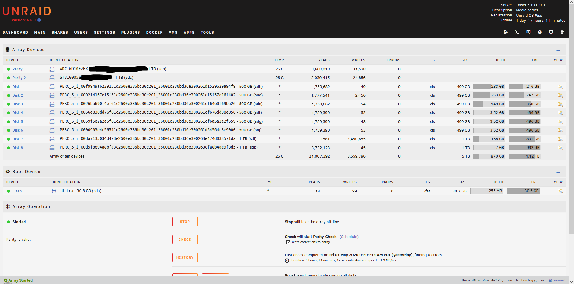

The server currently has a PERC 5/i controller, which only operates in raid mode. To get around this, I set up each drive to be its own raid-0 array. This works fine, but the controller does not pass serial numbers and model number info (or smart info) to Unraid, so it is hard to tell which drive is which.
I was able to identify which drives go into which slots, but if I need to replace a drive or change the configuration, it will be unnecessarily difficult. Not to mention what do I do if the controller dies.
