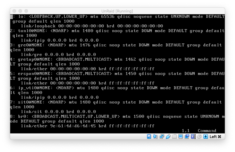

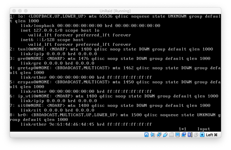

At any rate, as a starting point, can you boot in normal mode (not GUI), login as root from the command prompt, and share the results of:
ip link
ip addr

I attached screenshots of the commands you suggested (I found way to copy the content of the VBox window as text rather than as screenshot?)

Short answer first: What you need to do is to attach the actual USB stick to your VM (you can leave the VHD to be booted from, but make sure the actual stick is available to the VM).
Longer answer: Unraid OS is built in such a way that the stage-1 boot does not see HDDs, but does see USB-attached sticks. Drivers required for the subsequent stages can be loaded from the USB stick. If the USB stick is not available, those drives will not be loaded, and, among other things, the network will not be accessible.
