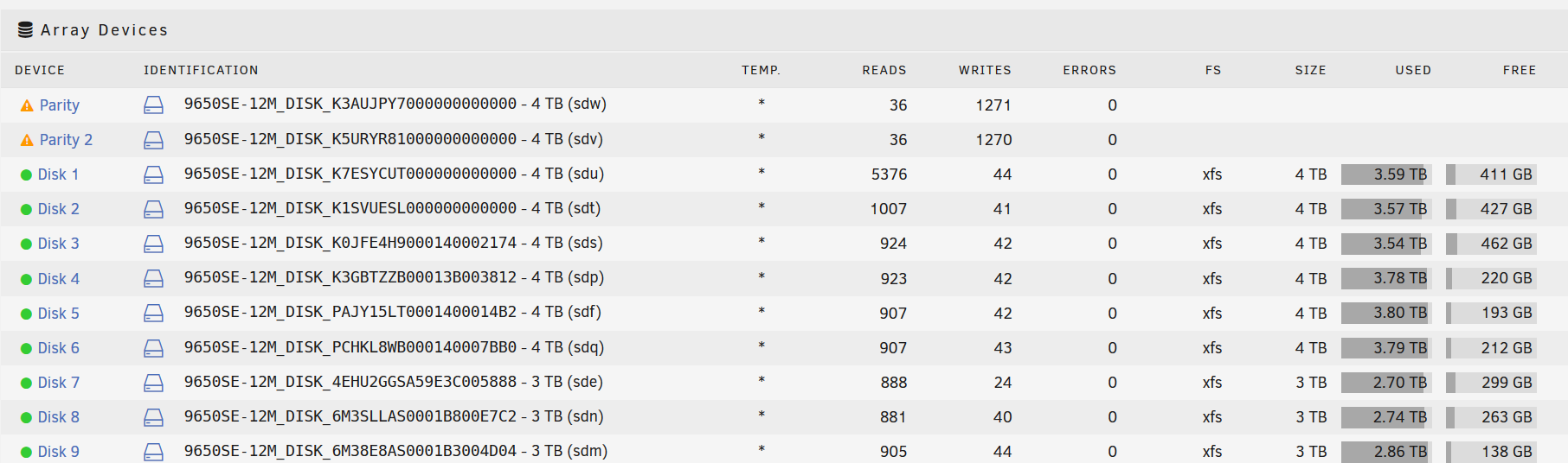

Have two(2) 3ware 9650-12 M cards connected to most of my drives
Cannot run SMARTCTL on any of my drives  off the 3ware 9650 either from the command line or the the unraid Gui. ( works fine on the drives directly connected to MB)
Had HD problems – one of my drives went bad, I replaced it;  rebuilt it successfully from my parity drives. All good.
 Then  one of my scsi backplanes went bad on my Norco box , have had to rejig the drives, and move some of them to internal SATA ports, and have had nothing but trouble since.
Needed to rebuild my parity drives (long story) ; but now keep running into HD related issue –  maybe its the SCSI card ; or some configuration on the SCSI card, or some incorrect configuration on my unraid.
 Wanting to check the status of the remaining drives , and found out that I cannot run smartctl  and cannot run them.
Help?????????????????????
I also get teh following errors
             May 4 15:35:01 Tower kernersl: program smartctl is using a deprecated SCSI ioctl, please convert it to SG_IO
             May 4 15:35:01 Tower kernel: 3w-9xxx: scsi20: ERROR: (0x03:0x0101): Invalid command opcode:opcode=0x80.
I have attached the output from
       ls -l /dev/disk/by-id
       /root/mdcmd status
And the smartctl commands that I have tried to run
       smartctl -d 3ware,1 -a /dev/sdu
       smartctl -d 3ware,1 -a -s on -T verypermissive /dev/sdu
and the diagnostics logs
Drive /sdu is my disk1
All the other drives off the 3650  show exactly teh same.
lsbyid.txt mdcmd-status-output.txt smartctl-1.log smartctl-2.log tower-diagnostics-20200504-1550.zip

If I had to hazard a guess it's because you're using RAID controllers rather than HBA's. I'm guessing each drive is an individual RAID 0 array which means the physical drive is not exposed to Unraid.
While this works it is not at all the recommended way to run Unraid. the LSI SAS cards with IT firmware work great with Unraid.

I think you might be right - I thought it might be something with the raid card configuration - if I go to card setup (alt-3 during boot up) some drives show as "JBOD" , others show as "Single".
Could not find a way to reconfigure them all as JBOD, if anyone knows, feel free to chime in.
