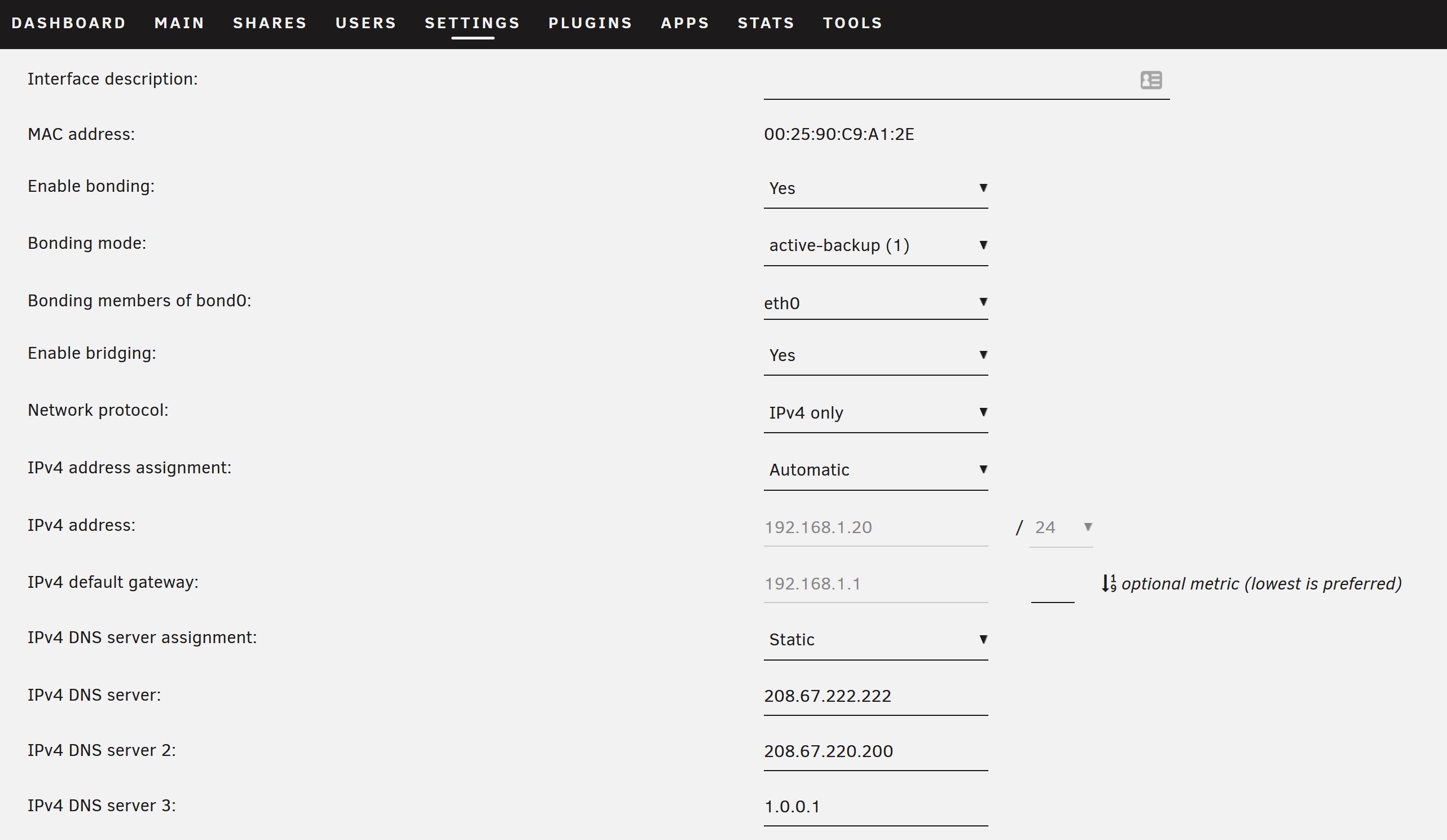

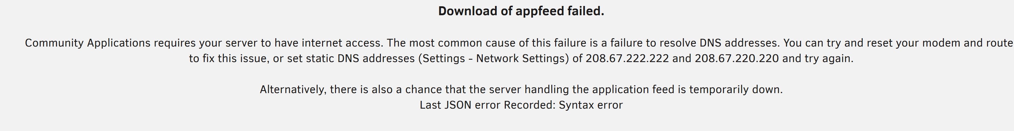

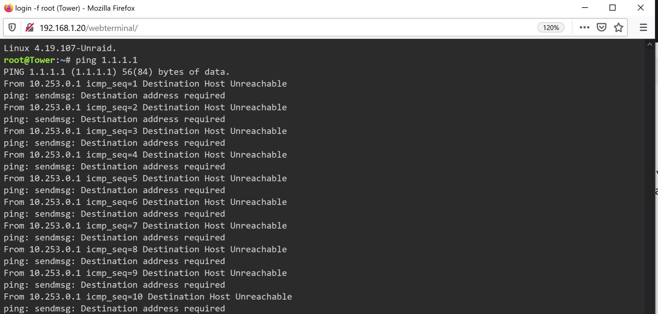

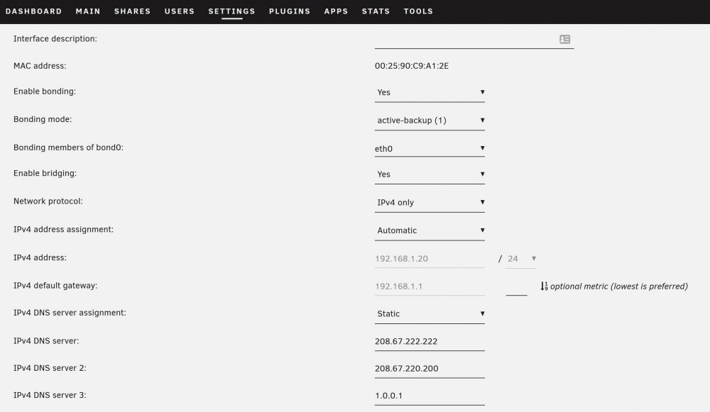

All of a sudden, I am having major issues with networking on my Unraid server. I can access the server from my network, but it doesn't seem to be able to access the internet at all. If I try to ping an internet server, it says 'host unreachable'. One thing I noticed is that I am using a 192.168.1.x network, but when I try to ping from the server, it looks like it is trying to use a 10.253.0.x address.
And I have tried using automatic DNS servers as well as 1.1.1.1 and 8.8.8.8
Switch off the wireguard tunnel.
Apparently you have configured  WG tunnel for vpn access and all traffic goes over the tunnel to reach the internet
I removed the wireguard because I couldn't get it working correctly. Same issues. I ended up wiping the USB drive and it all works now. Even reinstalled wireguard and it works properly now.
