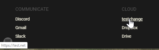

Just tried to edit the links.json file.  Those will not change.  Removed "Box" under "CLOUD" and changed it to my Seedbox URL - the "Box" link stayed.  Changed the Youtube link from youtube.com/subscriptions to just youtube.com - again youtube.com/subscriptions showed back up.
I stopped the docker and restarted it.  Still the same links appeared.  Now THAT is strange.
This is surely your cache, hold shift and refresh, or just clear your cache, try incognito, etc. I'm able to change those links just fine on my side and they're working over here.
image.png.5e4c4d078018d429cbced70a0749e365.pngimage.png.83276a6970ccf86483ab1f578e46c2eb.png
You are correct, cache issue.  That was strange because any other changes I made to the .json files appeared instantly.  It never occurred to me that the links section would be effected by the cache.

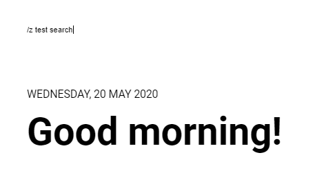

is it me or do custom providers not work?  I added my own provider which is a searx installation but the page is acting like the /z i made it isnt even doing anything.
Can you post your provider code? I'll take a peek.

It does show up in the options list in Search Options but doesnt seem to work is all, like the search.js isnt parsing the providers file or something?

Just did some testing it seems the only thing the provider file does is just list the providers in the system options not actually change what search providers can or cant be used in the search.js script
Reminder that I did not write SUI, someone else did, I just adapted it for a container and made some fixes.
You are correct though, all providers.json does after researching is simply show it on the UI, it doesn't actually code the function in.
In order to do that, you must edit search.js at line 59
It's pretty easy to add your own though, see my example added in here above allmusic.
The "case" or trigger is "z" so /z will trigger this in the search bar.
You can also add it to providers.json so it shows up in the GUI correctly as well so you can reference it later.
EDIT: Also updated the repository readme.md file on github with a similar example for future users wanting to do the same!

Yeah, I guess I should have said, I have figured out how to modify the code for myself but I guess to others it was misleading that it added your to the list if you modified that file.
I had assumed the same when i was checking this out, never tested it with any additional proivders though, glad you sorted it out. The readme is updated for anyone new that comes along that wants to poke at it too at least :) Thanks!
