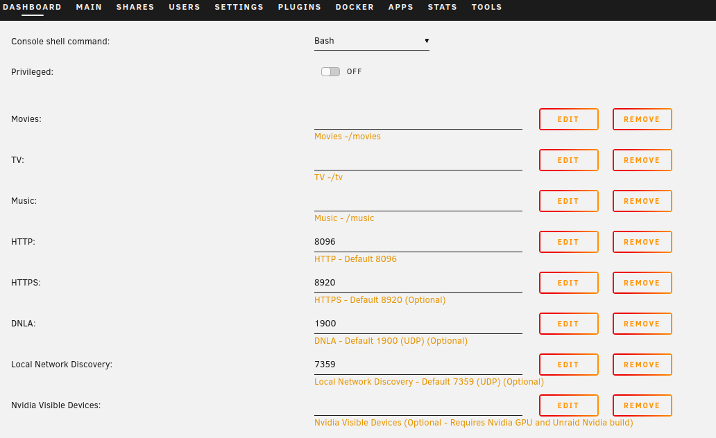

Please have a look at the screenshots:
Any ideas what I am doing wrong?

42 minutes ago, switch said:
Looks like you're passing through the device incorrectly. Pass just /dev/dri, not /dev/dri/renderD128. See if that helps.
37 minutes ago, Civic1201 said:
Same result as before with renderD128...

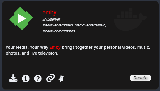

Ok, this works better.
But I can not open the web ui and I have no idea where to enter the appdata config.
edit: OK, container is running but still 100% cpu load while transcoding. This is frustrating.

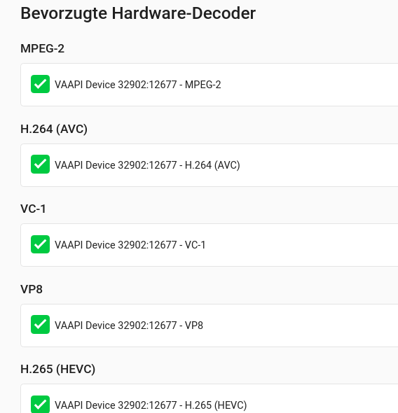

With the new container I get this in Emby.
YES, finally! Thank you very much @ CS01-HS
Glad it worked. It's a nice little board.
