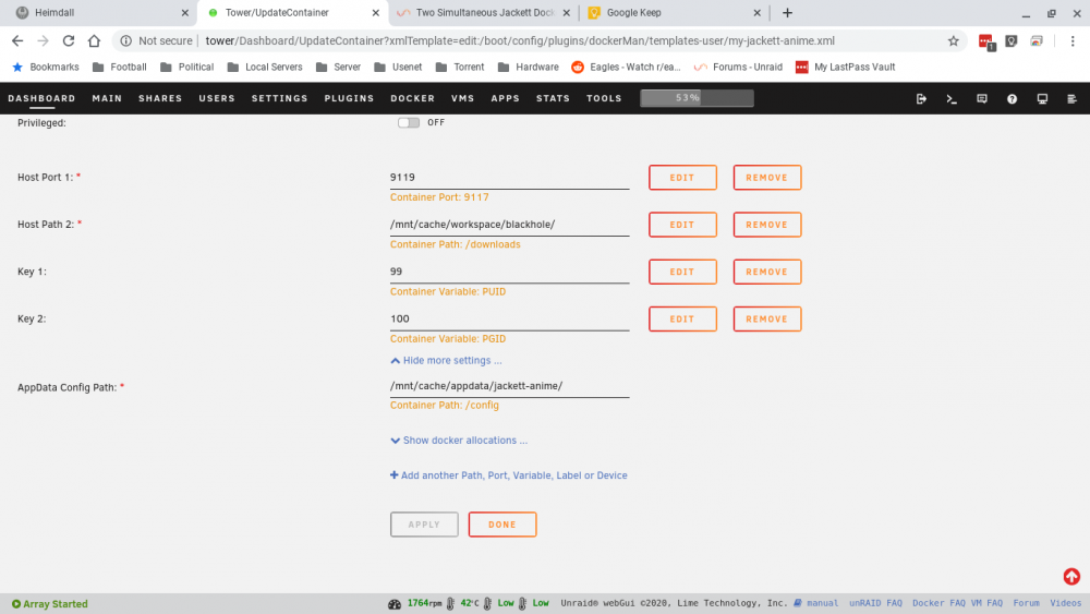

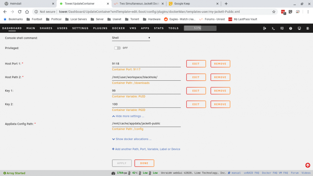

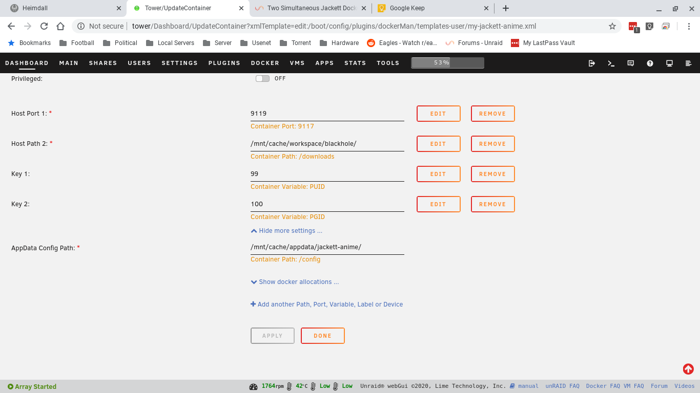

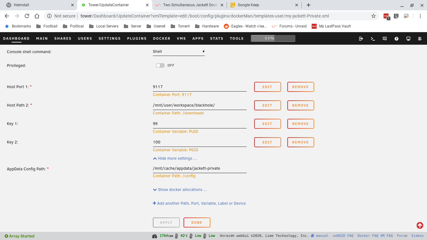

I have three instances of linuxserver jackett running - public trackers, private trackers and anime trackers.  Using different appdata folders and ports, everything works fine
you're using the same linux server docker, just 3 different instances, i wonder if that has anything to do with your success? I tried different ports and appdata... at your convenience, would you mind sharing a screenshot of your container configs w/ ports?
Here you go!  As you can see, different port # and appdata locations, nothing else needed tweaking

I think I know what's going on.  In my case, each one of the Jackett instances is using a different set of trackers (public trackers, private trackers and anime trackers).  It looks like you are using the same trackers in each instance.  I don't think that will work because your using the same credentials for simultaneous logins
