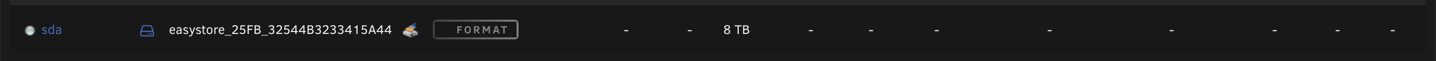

Hey everyone, I recently had some cabling issues with a hard drive and so I removed it from the array. I haven't had a chance to build parity yet, I started with unraid relatively recently.
I am trying to recover the data on the drive. It is recognized by unRAID when I use the WD Easystore SATA -> USB adaptor:
However, I don't understand how I can mount it to recover the files? Any advice on this? The drive is formatted to XFS.

Thanks for the help. Attached are the diagnostics.
1. I have never built parity.
2. I haven't tested whether or not the drive is recognized by the mobo.
3. It is not recognized by unraid when plugged into an internal SATA port. It was before, and on a restart, it stopped being recognized, and so I removed it because the sata connector on the hard drive is missing plastic. It was working despite this plastic damage before.
4. I am using the SATA -> USB adapter because I see it showing up on unRAID, the USB adapter seems to fit the SATA connector on the hard drive better than a standard SATA cable. This is a last resort to try and get it working, sorry I know that's complicated.
FYI the adapter is what is inside the WD easystore case that's removed when you shuck it, I had one saved.
EDIT: getting "emhttpd: device /dev/sdg problem getting id" in the drive's log now. Might be permanently damaged..
EDIT2: i guess it got the ID eventually: "emhttpd: WD_easystore_25FB_32544B3233415A44-0:0 (sdg) 512 15628052480"

The easystore USB-SATA adapter is most likely causing the issue. Is there any way you can attach it to a different internal SATA? Maybe get a cheap 2 port asmedia SATA card?
