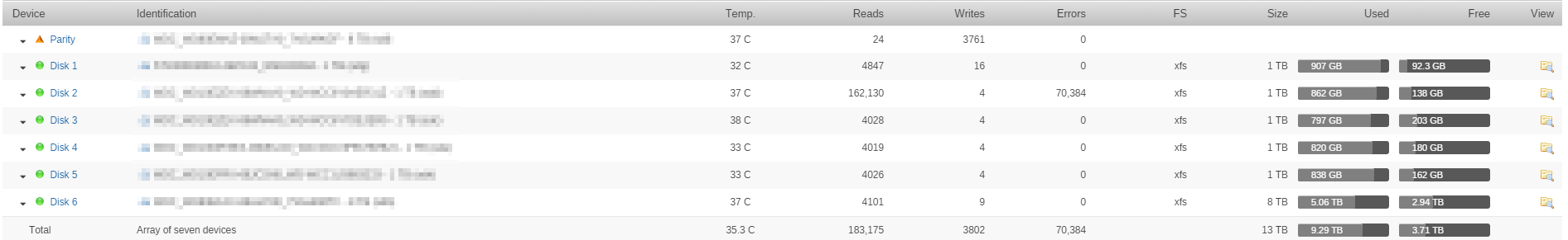

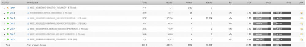

I seem to have lost my parity drive as it shows disabled. I've checked my SATA and power cables and they seem to be fine as the BIOS detects the drive. I'm also able to run SMART tests on the drive.
701239742_2020-05-2722_33_12-VIA-NAS01_Main.thumb.png.5a3c83407d2a3bfc629fb968f16fb3de.png
Attached are the diagnostics I just ran.
Any help is greatly appreciated - thanks in advance!
via-nas01-diagnostics-20200527-2029.zip
First check filesystem on disk1 since it's unmountable, then re-sync parity, and if it happens again make sure you grab the diags before rebooting, you should also upgrade Unraid and fix the advanced buttons plugin spamming your log.

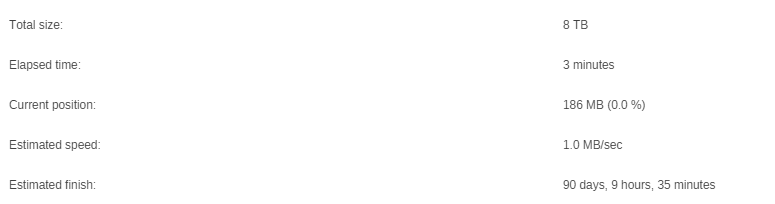

I did what you suggested and my data drive is now back online. I started the parity sync but it is going extremely slow.

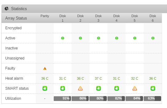

Even slower, now.
Edited by QPlus7
I think I found the problem. My disk2 looks to be trashed.
