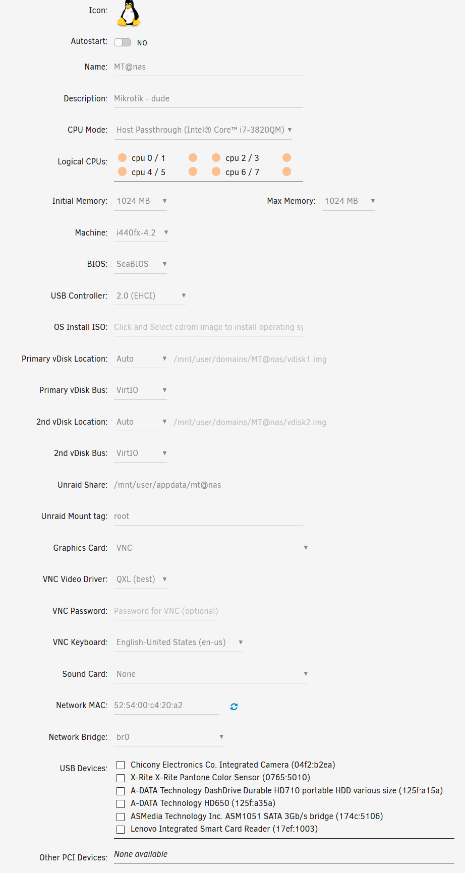

I have installed Mikrotik CHR as VM on unraid. My configuration looks like on the attached image. I am experiencing networking problem. When I am logging in to the dude server using dude program it say "getting stuff" at the bottom. During this stage latency to my mikrotik VM jumps above 100 ms, like that:

What can be causing the problem? I have tested with one cpu, two cpus and all cpus passed to vm.

I have installed Mikrotik CHR version with VM setting as in my first post. What is amazing is that Mikrotik gives CHR version for free!! :)
Is it possible to install some app/plugin to get more qemu options to configure? I dont see howto create second network interface in unraid for instance.
I have found the answere. Mikrotik CHR free version has bandwidth limit on single interface 1Mbit. Dude is using ping to probe latency, so every logging in to dude server causes traffic that will make false reading for dude ping probe, as it wil overfill bandwidth. To solve this problem following rules can by applied in the mikrotik terminal:
