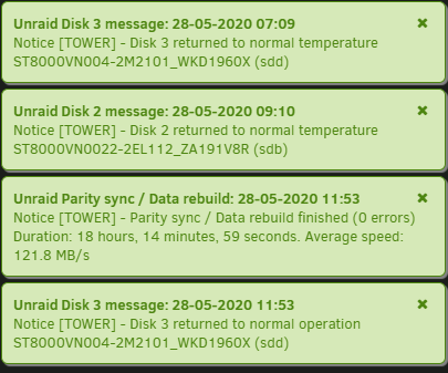

I have had problems with one of my disks in my array since i installed it...
A couple of days ago i found it with "Unmountable: No file system" error. I assume it failed without doing much of any testing.
I have now preformed a parity sync / data rebuild on the replacement disk but that one also has the same error.

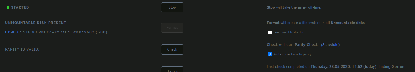

In the array operation tab i get the option to format the disk.
In the guide i found on how to replace a failed disk it says nothing about having to format it after data rebuild
The guide i found: https://wiki.unraid.net/Replacing_a_Data_Drive
Edited by PetterH
Do NOT format it unless you want to lose its contents.
You might want to read this section of the official documentation.   If a disk shows as unmountable before doing a rebuild then it will always show the same after a rebuild.   The way to clear an ‘unmountable’ status is to run the appropriate file system repair tool.
