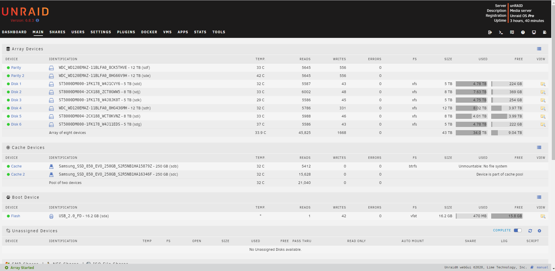

Earlier today I was noting that Plez was not loading poster images. I went and checked UnRAID just to find the message "Unmountable: No file system" to the right of the cache. I have no clue what happened. Nothing about the setup has been changed in a good while and I have no clue what to do to fix it.

One of the devices is considered missing (despite being assigned), this suggests the superblock is damaged, and it's failing to mount read/write with a single device due to no redundancy, at least partially (this could be the result of the pool not being redundant if it was created during v6.7.x due to a bug):
May 28 12:33:14 unRAID kernel: BTRFS warning (device sdc1): chunk 101054414848 missing 1 devices, max tolerance is 0 for writeable mount
May 28 12:33:14 unRAID kernel: BTRFS warning (device sdc1): writeable mount is not allowed due to too many missing devices
You should be able to recover the data by mounting read only, see here.

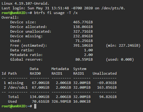

Post output of:
btrfs fi usage -T /x

19 hours ago, johnnie.black said:
Post output of:

Just do a regular copy, you can use for example midnight commander (mc on the console), not sure all data will be available since it was a raid0 pool, copy what you can.
