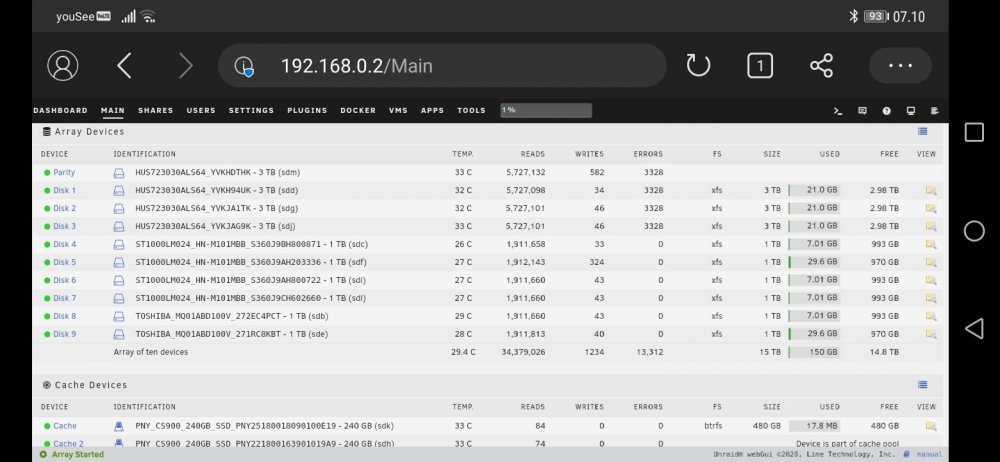

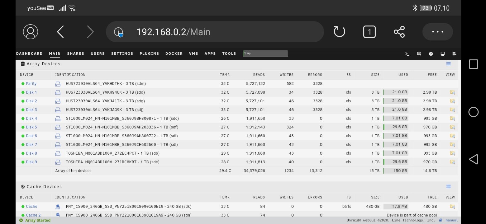

I am running new config 4 sas disk and some 1tb sata disk on ny hp DL380e g8 with h220 raid controller. I have strange disk write/read errors on my 4 sas disk when i am doing disk parity check. Is there anybody can help me to find out what is going wrong? 🙄

May 30 05:37:21 Unraid-G8 kernel: sd 1:0:5:0: [sdg] Unaligned partial completion (resid=148208, sector_sz=512)
Not sure what it means, if the SAS disks share a miniSAS cable or power splitter/source try changing that first, but could be a more specif issue, or even a compatibly problem.
Preclear my sas disks solved the problem. Thank you for your reply👍
