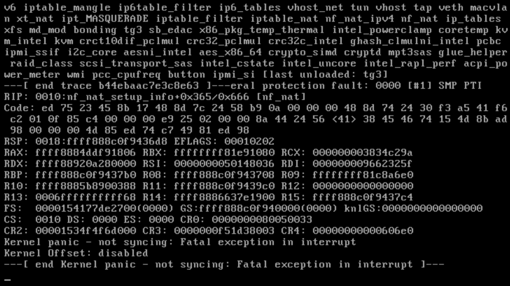

When I console in through idrac, I see some messages like this (attached)

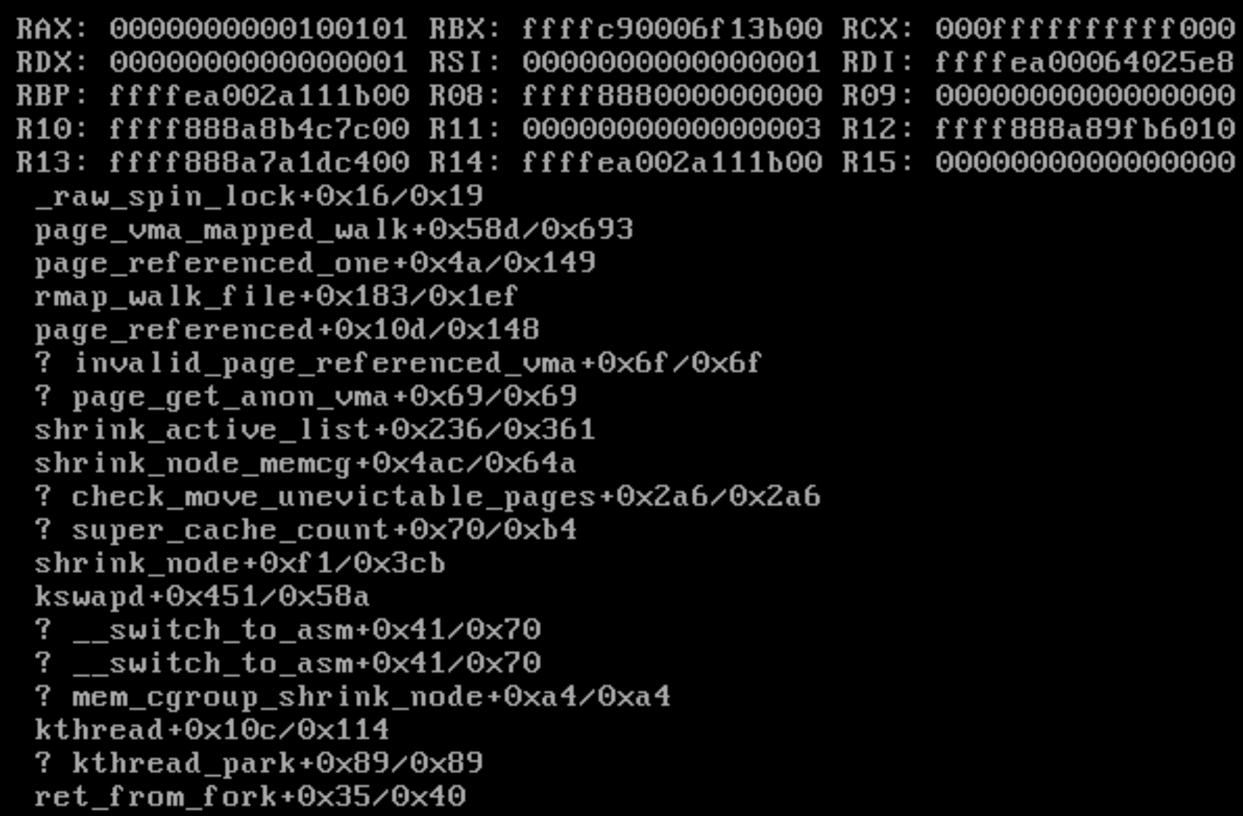

Thanks. I've deleted the docker image and re-installed my containers from community applications. I stepped away during the install of the containers. It looks like it finished, as all my containers are there, but it looks like sometime after the system had a kernel panic, and the system became unresponsive. I had to do a power cycle via the idrac.
I've attached a screenshot of the unresponsive console with the kernel panic, as well as the syslog output from today.
After power cycling, unraid is back up and everything seems to be running ok for now. I'll continue to monitor to see what happens

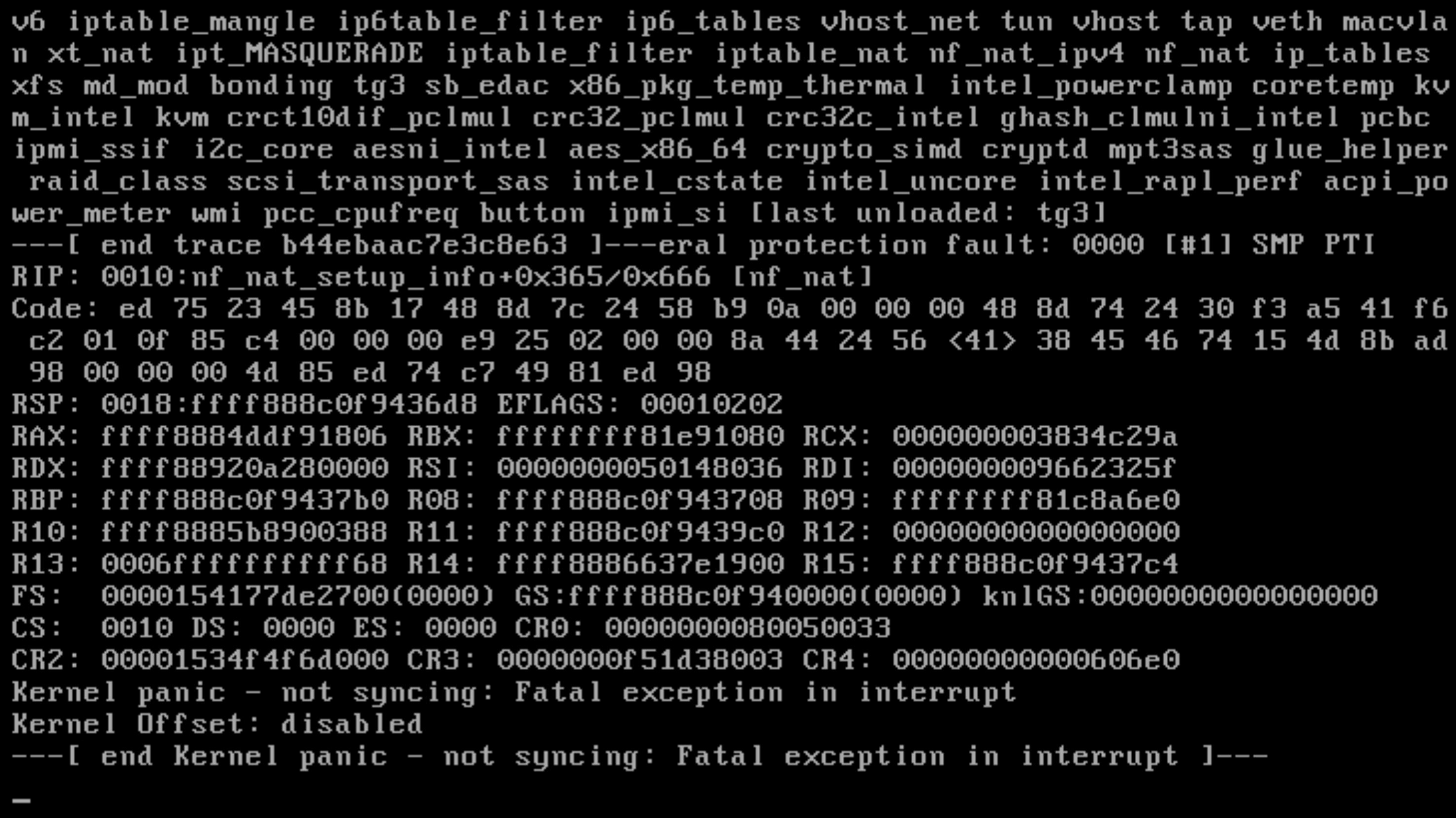

So, had a few good days with zero issues, then looks like around 1am today (tuesday), looks like server crashed and went unresponsive again, had to power cycle through idrac interface
Here's the syslog from the past 2 days. another kernel panic on the console output
Any ideas?
SyslogCatchAll-2020-06-29.txt SyslogCatchAll-2020-06-30.txt
Crash appears to be network related, try simplifying your network as much as possible to test, remove any bonding if enable, also any dockers with custom IP addresses.
hey all, checking in here, system has been stable for about 2 weeks now. it seems the culprit may have been a pi-hole docker container i was running that was having issues to begin with on its own. ever since removing that container, it seems to have been running stable. going to keep monitoring for a while, but hopeful that may have been the solution. appreciate the help!
