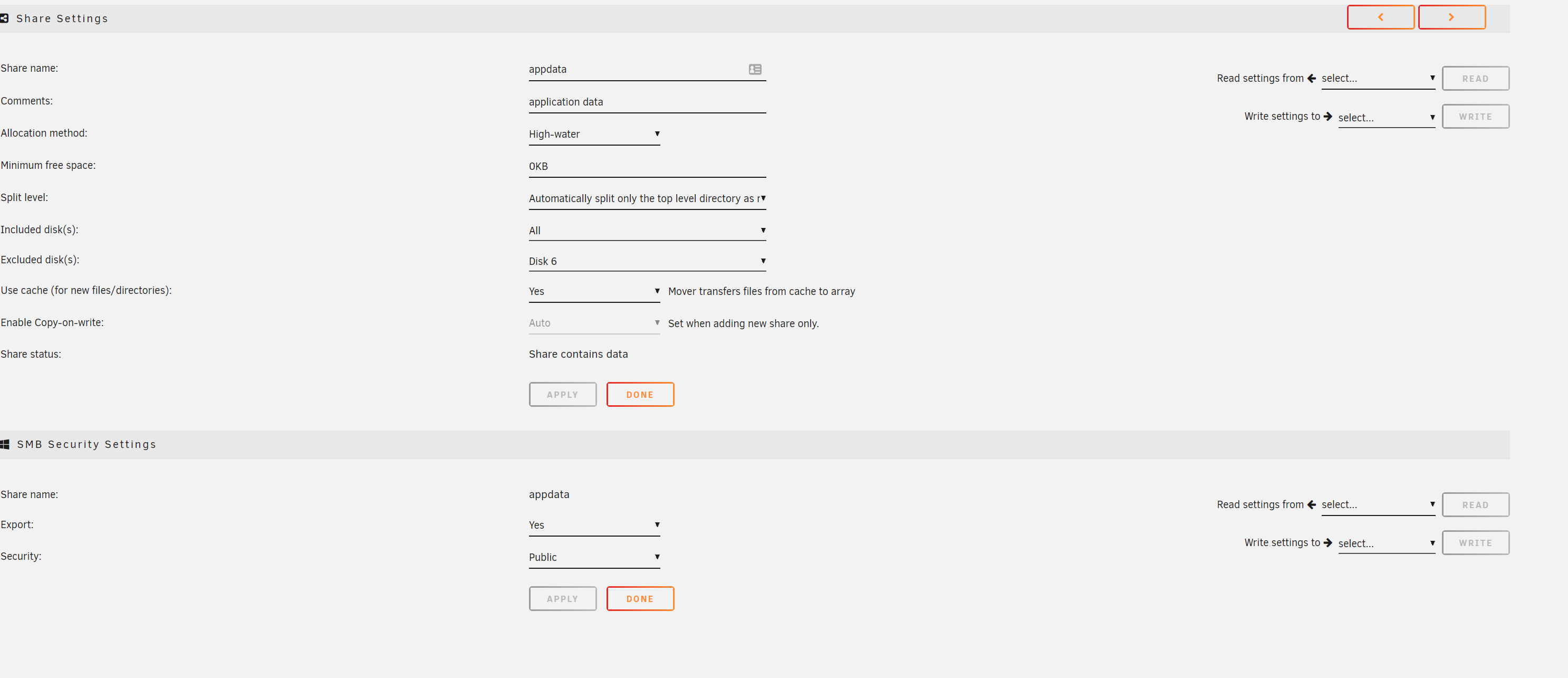

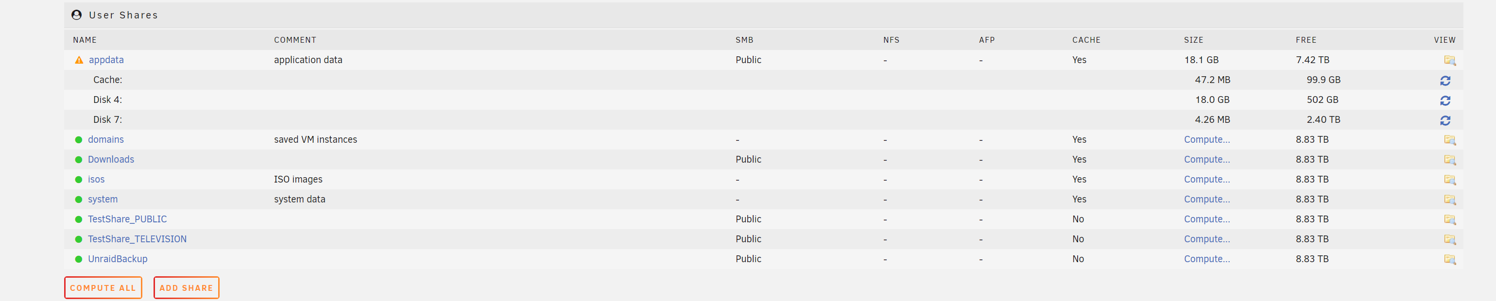

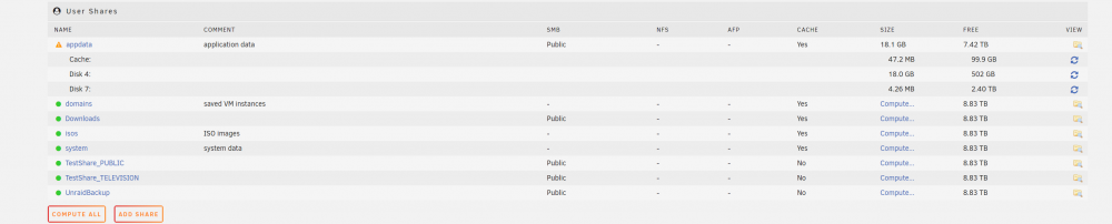

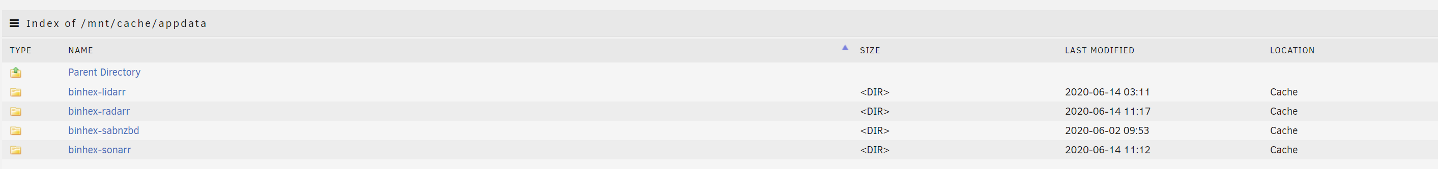

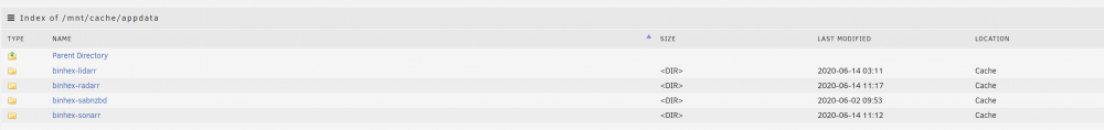

I'm in the process of upgrading my cache drive by following the wiki directions.  I've got as far as changing all the shares that are using the cache to Yes, and using the mover (i did disable docker in Settings).  It moved everything but my appdata.  Its still there.  I verified that i have the appdata share set to Yes but the mover isn't moving it off the cache to the array.
Any ideas?
