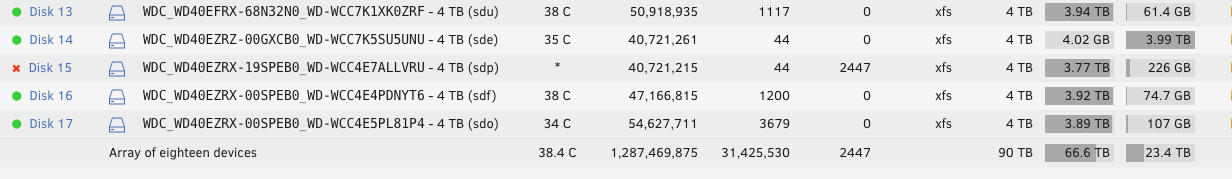

Hi Guys,
this morning I got this...
1685335482_ScreenShot2020-06-15at9_05_35AM.thumb.png.8093a17c8f48102aa48be392af1274e3.png
This is not the first time but every time I messed up with something and I lost data... So this time I would like to do it correctly and hope I will not have the previous bad experience. Attached a diagnostic file if it helps to verify the integrity of the system.
Thanks for patience and help.

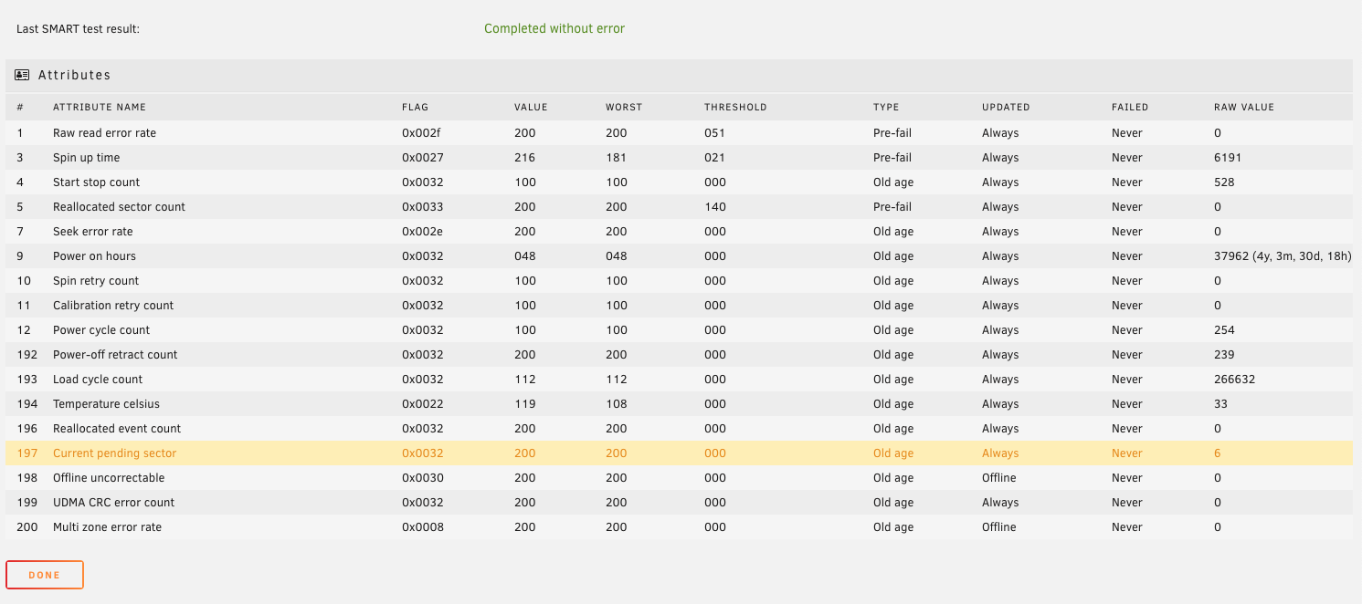

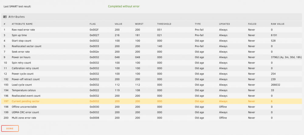

Disk15 is showing some pending sectors, run an extended SMART test to confirm if it's really failing.
SMART test passed so disk fine, at least for now, and those pending sectors are "false positives", replace/swap both cables to rule them out and rebuild on top.

1 hour ago, gideva said:
Disconnect the cables and plug them in again
That won't accomplish much, best to replace or swap the cables with another disk to rule them out.
3) Remove the disk
6) reinstall disk
I suppose you mean unassign and re-assign the disk here, if yes that's correct
