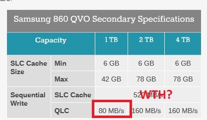

You are ignoring all the technical limitations of the hardware.  In both recent threads about speeds you've asked about "how" the files are being moved or are concerned with the type of drive while not taking into consideration how the drives actually operate.
I'm no expert at SSD speeds but when the evidence is plainly spelled out by manufacturers it's hard to expect anything more.
Samsung SSD "up to" 520MB/s write speed.. "The sequential write performances are measured with Intelligent TurboWrite technology being activated. The sequential write performances may not be sustained for the portion of data exceeding over Intelligent TurboWrite buffer size."
That's quite a difference from the advertised speeds.  And if he were writing to the 860, he's got write cache of only 512MB up to 4GB depending on the model, then everything slows down.  Same with whatever NVMe he's using.
I agree that the OP should provide more details, but from what I've been seeing while researching this issue I don't think any details about the hardware or how the files are being moved is going to make a difference.  There's a physical limitation to the drive.  And how far should you drill down on the hardware?  What if the SSD and the NVMe are sharing the same PCI-E lane?  How would that affect the speeds?
Maybe I'm wrong, and I'm open to being schooled, but there's enough evidence out there that suggests all forms of SSDs/NVMe's aren't as great as you'd expect them to be.

You quoted information about the 860 QVO, the OP said he has a "EVO 860". Evo is TLC, QVO is QLC. Major difference.

The graphic was from the QVO, the information was for the EVO, since details matter.  The point was that actual real world speed is different than what is advertised.
