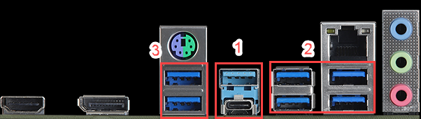

I put Unraid where no. 3 is and my USB keyboard and mouse on no. 2. Originally I put Unraid on no.1 and USB can’t be passed onto VM without issue, I suspect no. 1 and 2 share the same USB bus. NVME is unassigned device and together with no. 2 are what I passed onto the VM. VM ACS setting is set to disabled and the following is my VFIO-PCI config settings (thanks Skittal).

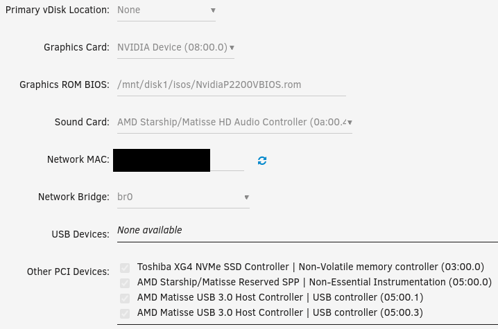

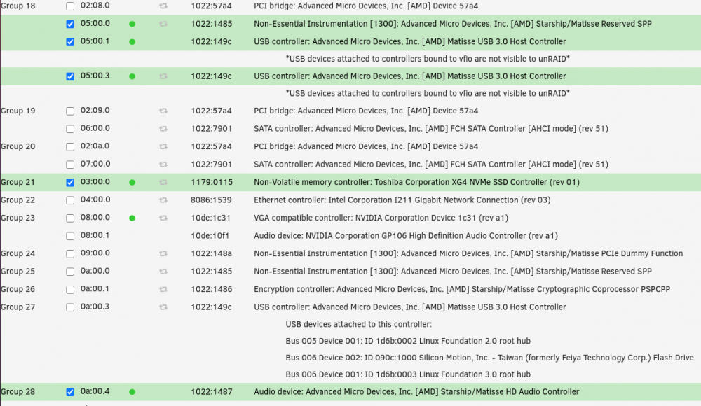

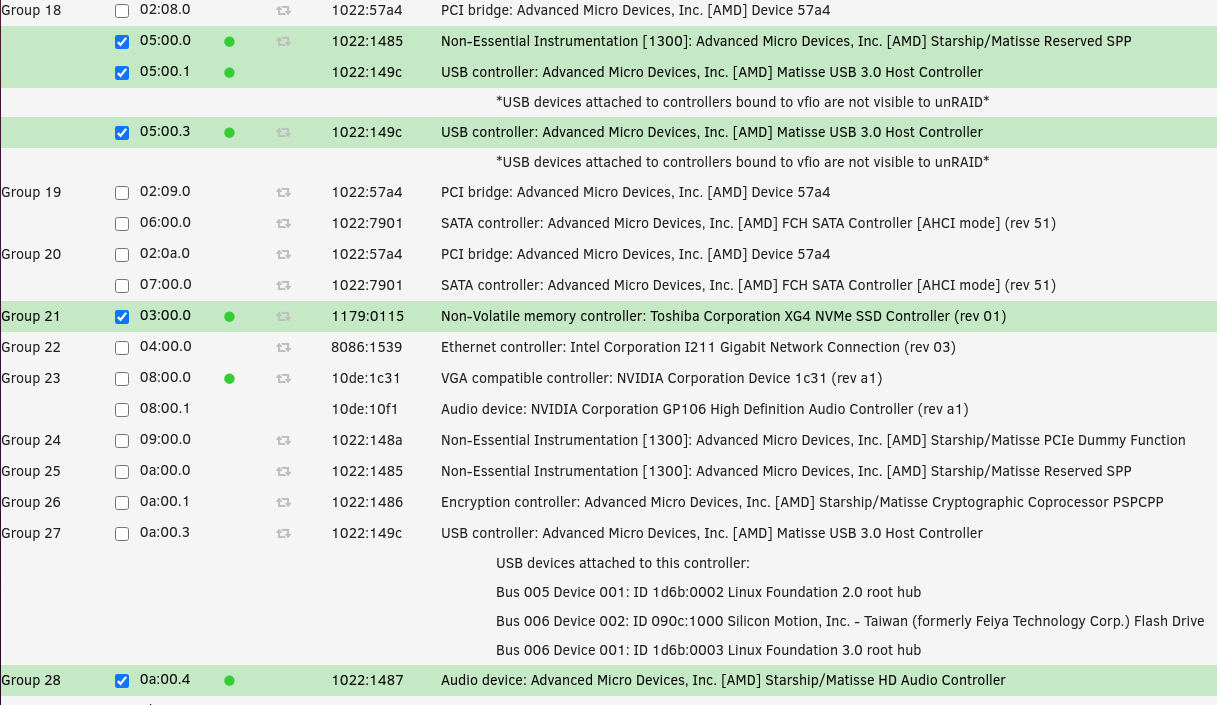

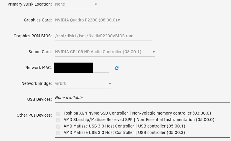

I had struggled to get the VM to boot to bare metal Windows installed on NVME, I tried re-installing Windows trying to get a legacy boot instead of UEFI thinking that was an issue, I even ordered a Samsung EVO 860 thinking it was the vendor ID issue etc. The issue turned out to be that I can’t use i440, I can only use Q35.

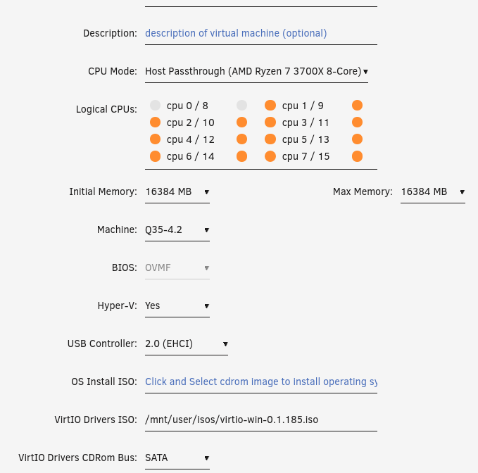

The following is the VM setup, I copied the UUID from the baremetal and inserted it here.
Compare to other examples I’ve followed, the biggest impact setting for my setup is Q35 below.
For this next page the biggest issue is passing the USB, once I figured out which USB outlet works with what, then I read Skittal’s posting on his X570, that helps in finalizing the VFIO-PCI config which leads to the setting here. I dumped my own VBIOS using GPU-Z following SpaceInvaderOne’s instruction to remove the header from the VBIOS.
Now I can use my VM the way I intended to use it for while booting from the same instance bare metal.
