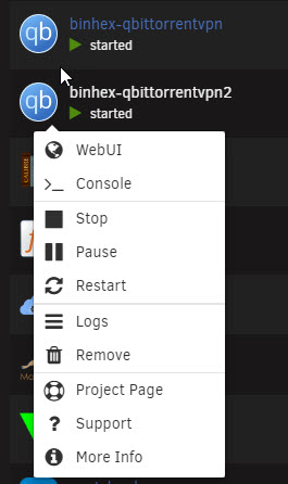

  8. OK, background story is I had a scare when upgrading from 6.9.3 to what I thought was 6.12.3. After the upgrade to 6.10.3, there seems like a USB issue that prevented Unraid boot up, I had to restore from 9 months USB Backup. It is most likely this USB Backup does not have some of the later Dockers and/or Shares setup. So, Docker tab show 2 instances of the QbittorrentVPN with the correct naming, but the second one has no edit (right below Logs before Remove there should be an Edit option). How do I correct or manually edit all these "changes" that were added to Unraid after this backup was done last year? In this case how do I get edit back? Thanks.
