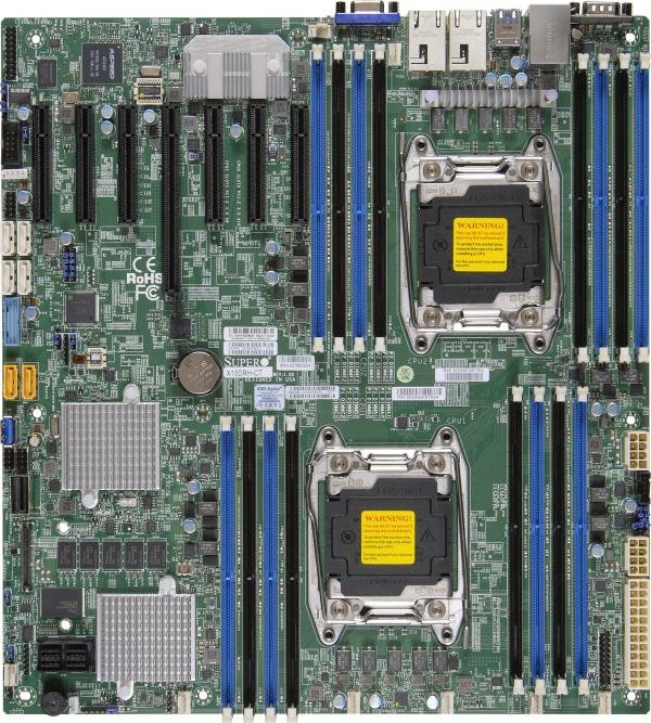

HI all, My name is Darren, I'm a new Unraid server builder , I am trying to decide on a motherboard and have been offered this at a OK price -
Supermicro X10DRH-C
I am not overly savvy with IT skills, but wondered if there was anything I should know before ordering, i.e - is unraid going to work on basically any E5 2000 V3 series CPU motherboard ? The one I am looking at has the following specs -

there will be no problems with CPUs - unraid works with most hardware that can run Linux..
but i'm not sure about LSI controller - LSI 3108 is RAID controller - these are not recommended for unraid.
you can choose https://www.supermicro.com/en/products/motherboard/X10DRH-CLN4
it have LSI 3008 - a plain HBA, works with unraid out of the box.

I have this same board. You will have to setup the LSI 3108 to JBOD is either IPMI or the firmware settings upon boot. Worked out the box for me. No flashing needed.
