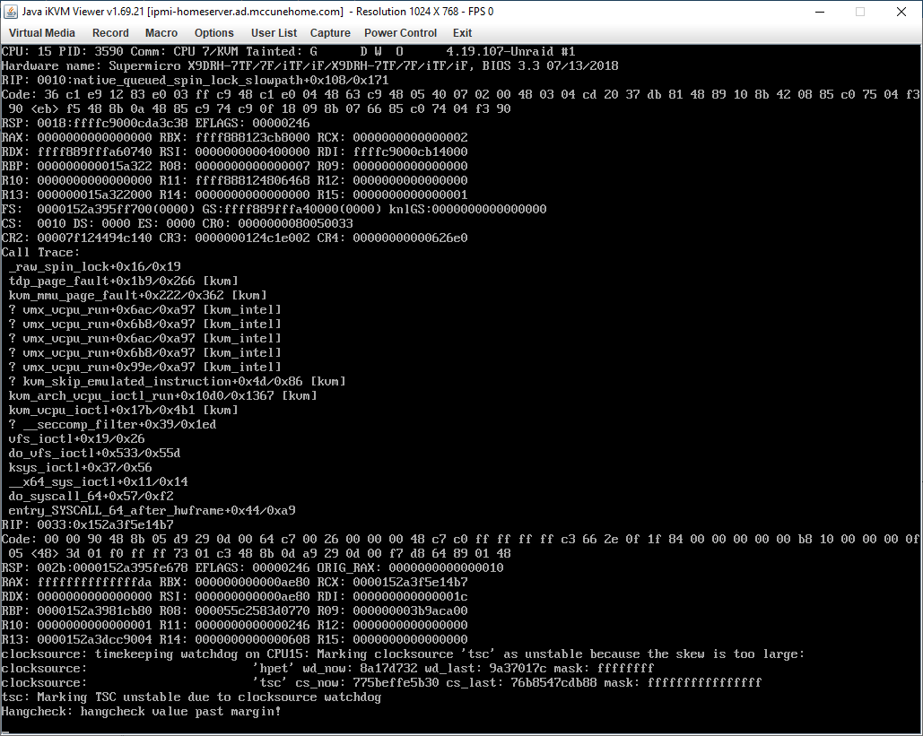

July 9, 20206 yr I feel pretty confident that the lockups have to do with the vms. I rebuilt this box and right now only have one vm on it. I see kvm references in the call stack on the crash information. My first thought is that maybe the storage that the vm is on might be plugged into a pcie lane that is connected to different physical cpu maybe? It's on an Intel i750 PCIE NvME drive plugged into PCIE Slot 2, which according to the diagram on page 1-4 of this manual: https://www.supermicro.com/manuals/motherboard/C606_602/MNL-1306.pdf Should be CPU1 In the attached "capture.png", which cpu's might be physical cpu 1 and which might be physical cpu 2?
July 9, 20206 yr Author Update: If I'm reading this correctly: root@SERVER1:/sys# lscpu --all --extended CPU NODE SOCKET CORE L1d:L1i:L2:L3 ONLINE MAXMHZ MINMHZ 0 0 0 0 0:0:0:0 yes 2500.0000 1200.0000 1 0 0 1 1:1:1:0 yes 2500.0000 1200.0000 2 0 0 2 2:2:2:0 yes 2500.0000 1200.0000 3 0 0 3 3:3:3:0 yes 2500.0000 1200.0000 4 0 0 4 4:4:4:0 yes 2500.0000 1200.0000 5 0 0 5 5:5:5:0 yes 2500.0000 1200.0000 6 1 1 6 6:6:6:1 yes 2500.0000 1200.0000 7 1 1 7 7:7:7:1 yes 2500.0000 1200.0000 8 1 1 8 8:8:8:1 yes 2500.0000 1200.0000 9 1 1 9 9:9:9:1 yes 2500.0000 1200.0000 10 1 1 10 10:10:10:1 yes 2500.0000 1200.0000 11 1 1 11 11:11:11:1 yes 2500.0000 1200.0000 12 0 0 0 0:0:0:0 yes 2500.0000 1200.0000 13 0 0 1 1:1:1:0 yes 2500.0000 1200.0000 14 0 0 2 2:2:2:0 yes 2500.0000 1200.0000 15 0 0 3 3:3:3:0 yes 2500.0000 1200.0000 16 0 0 4 4:4:4:0 yes 2500.0000 1200.0000 17 0 0 5 5:5:5:0 yes 2500.0000 1200.0000 18 1 1 6 6:6:6:1 yes 2500.0000 1200.0000 19 1 1 7 7:7:7:1 yes 2500.0000 1200.0000 20 1 1 8 8:8:8:1 yes 2500.0000 1200.0000 21 1 1 9 9:9:9:1 yes 2500.0000 1200.0000 22 1 1 10 10:10:10:1 yes 2500.0000 1200.0000 23 1 1 11 11:11:11:1 yes 2500.0000 1200.0000 root@SERVER1:/sys# Then the logical cpu selection corresponds to: 0,12, 1,13, 2,14, 3,15, 4,16, 5,17 are physical cpu #1 6,18, 7,19, 8,20, 9,21, 10,22, 11,23 are physical cpu #2 Which makes sense, but shoots a hole in my theory about the pcie bus

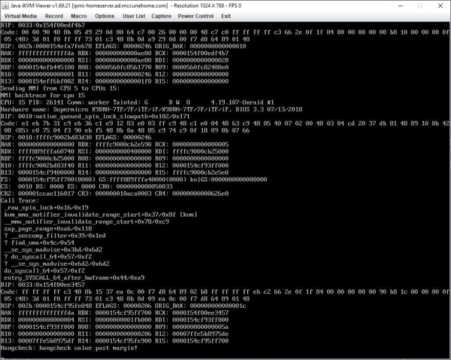

July 10, 20206 yr Author Was watching system log this time when it crashed....This was in it, and the console is a little different this time Jul 9 23:29:17 SERVER1 kernel: BUG: unable to handle kernel NULL pointer dereference at 0000000000000040 Jul 9 23:29:17 SERVER1 kernel: PGD 0 P4D 0 Jul 9 23:29:17 SERVER1 kernel: Oops: 0000 [#1] SMP PTI Jul 9 23:29:17 SERVER1 kernel: CPU: 5 PID: 3593 Comm: CPU 10/KVM Tainted: G W O 4.19.107-Unraid #1 Jul 9 23:29:17 SERVER1 kernel: Hardware name: Supermicro X9DRH-7TF/7F/iTF/iF/X9DRH-7TF/7F/iTF/iF, BIOS 3.3 07/13/2018 Jul 9 23:29:17 SERVER1 kernel: RIP: 0010:drop_spte+0x4b/0x78 [kvm] Jul 9 23:29:17 SERVER1 kernel: Code: 4c 01 e0 72 09 ba ff ee 00 00 48 c1 e2 1f 48 01 d0 ba f5 ff 7f 00 4c 89 e6 48 c1 e8 0c 48 c1 e2 29 48 c1 e0 06 48 8b 54 10 28 <48> 2b 72 40 48 89 d7 48 c1 fe 03 e8 63 d6 ff ff 48 89 ef 48 89 c6 Jul 9 23:29:17 SERVER1 kernel: RSP: 0018:ffffc9000ce53c50 EFLAGS: 00010202 Jul 9 23:29:17 SERVER1 kernel: RAX: 000000007f20a640 RBX: ffffc900243250e0 RCX: 0000000000000000 Jul 9 23:29:17 SERVER1 kernel: RDX: 0000000000000000 RSI: ffff889fc8299668 RDI: 7fffc4408733186c Jul 9 23:29:17 SERVER1 kernel: RBP: ffffc9000cb14000 R08: 0000000000000001 R09: 0000000000000000 Jul 9 23:29:17 SERVER1 kernel: R10: 0000000000000000 R11: 0000000000000000 R12: ffff889fc8299668 Jul 9 23:29:17 SERVER1 kernel: R13: 0000000000000000 R14: ffff8884a1450000 R15: ffff8884a1450008 Jul 9 23:29:17 SERVER1 kernel: FS: 0000152a383ff700(0000) GS:ffff889fff940000(0000) knlGS:0000000000000000 Jul 9 23:29:17 SERVER1 kernel: CS: 0010 DS: 0000 ES: 0000 CR0: 0000000080050033 Jul 9 23:29:17 SERVER1 kernel: CR2: 0000000000000040 CR3: 0000000124c1e005 CR4: 00000000000626e0 Jul 9 23:29:17 SERVER1 kernel: Call Trace: Jul 9 23:29:17 SERVER1 kernel: kvm_zap_rmapp+0x3a/0x5e [kvm] Jul 9 23:29:17 SERVER1 kernel: ? kvm_io_bus_read+0x43/0xcc [kvm] Jul 9 23:29:17 SERVER1 kernel: kvm_unmap_rmapp+0x5/0x9 [kvm] Jul 9 23:29:17 SERVER1 kernel: kvm_handle_hva_range+0x11c/0x159 [kvm] Jul 9 23:29:17 SERVER1 kernel: ? kvm_zap_rmapp+0x5e/0x5e [kvm] Jul 9 23:29:17 SERVER1 kernel: kvm_mmu_notifier_invalidate_range_start+0x49/0x8f [kvm] Jul 9 23:29:17 SERVER1 kernel: __mmu_notifier_invalidate_range_start+0x78/0xc9 Jul 9 23:29:17 SERVER1 kernel: change_protection+0x300/0x879 Jul 9 23:29:17 SERVER1 kernel: change_prot_numa+0x13/0x22 Jul 9 23:29:17 SERVER1 kernel: task_numa_work+0x20b/0x2b5 Jul 9 23:29:17 SERVER1 kernel: task_work_run+0x77/0x88 Jul 9 23:29:17 SERVER1 kernel: exit_to_usermode_loop+0x4b/0xa2 Jul 9 23:29:17 SERVER1 kernel: do_syscall_64+0xdf/0xf2 Jul 9 23:29:17 SERVER1 kernel: entry_SYSCALL_64_after_hwframe+0x44/0xa9 Jul 9 23:29:17 SERVER1 kernel: RIP: 0033:0x152a3f5e14b7 Jul 9 23:29:17 SERVER1 kernel: Code: 00 00 90 48 8b 05 d9 29 0d 00 64 c7 00 26 00 00 00 48 c7 c0 ff ff ff ff c3 66 2e 0f 1f 84 00 00 00 00 00 b8 10 00 00 00 0f 05 <48> 3d 01 f0 ff ff 73 01 c3 48 8b 0d a9 29 0d 00 f7 d8 64 89 01 48 Jul 9 23:29:17 SERVER1 kernel: RSP: 002b:0000152a383fe678 EFLAGS: 00000246 ORIG_RAX: 0000000000000010 Jul 9 23:29:17 SERVER1 kernel: RAX: 0000000000000000 RBX: 000000000000ae80 RCX: 0000152a3f5e14b7 Jul 9 23:29:17 SERVER1 kernel: RDX: 0000000000000000 RSI: 000000000000ae80 RDI: 000000000000001f Jul 9 23:29:17 SERVER1 kernel: RBP: 0000152a3988a2c0 R08: 000055c2583d0770 R09: 000000000000ffff Jul 9 23:29:17 SERVER1 kernel: R10: 0000000000000001 R11: 0000000000000246 R12: 0000000000000000 Jul 9 23:29:17 SERVER1 kernel: R13: 0000152a3dcc0002 R14: 0000000000001072 R15: 0000000000000000 Jul 9 23:29:17 SERVER1 kernel: Modules linked in: vhost_net tun vhost tap kvm_intel kvm cdc_acm ccp xt_CHECKSUM ipt_REJECT ip6table_mangle ip6table_nat nf_nat_ipv6 iptable_mangle ip6table_filter ip6_tables xt_nat veth macvlan ipt_MASQUERADE iptable_filter iptable_nat nf_nat_ipv4 nf_nat ip_tables xfs md_mod ixgbe(O) sb_edac x86_pkg_temp_thermal intel_powerclamp coretemp crct10dif_pclmul crc32_pclmul crc32c_intel ghash_clmulni_intel pcbc aesni_intel aes_x86_64 crypto_simd cryptd glue_helper isci ipmi_ssif intel_cstate mpt3sas nvme libsas i2c_i801 ahci raid_class pcc_cpufreq scsi_transport_sas intel_uncore i2c_core intel_rapl_perf nvme_core libahci wmi ipmi_si button [last unloaded: tun] Jul 9 23:29:17 SERVER1 kernel: CR2: 0000000000000040 Jul 9 23:29:17 SERVER1 kernel: ---[ end trace 1c4b462ac4b3e0e1 ]--- Jul 9 23:29:17 SERVER1 kernel: RIP: 0010:drop_spte+0x4b/0x78 [kvm] Jul 9 23:29:17 SERVER1 kernel: Code: 4c 01 e0 72 09 ba ff ee 00 00 48 c1 e2 1f 48 01 d0 ba f5 ff 7f 00 4c 89 e6 48 c1 e8 0c 48 c1 e2 29 48 c1 e0 06 48 8b 54 10 28 <48> 2b 72 40 48 89 d7 48 c1 fe 03 e8 63 d6 ff ff 48 89 ef 48 89 c6 Jul 9 23:29:17 SERVER1 kernel: RSP: 0018:ffffc9000ce53c50 EFLAGS: 00010202 Jul 9 23:29:17 SERVER1 kernel: RAX: 000000007f20a640 RBX: ffffc900243250e0 RCX: 0000000000000000 Jul 9 23:29:17 SERVER1 kernel: RDX: 0000000000000000 RSI: ffff889fc8299668 RDI: 7fffc4408733186c Jul 9 23:29:17 SERVER1 kernel: RBP: ffffc9000cb14000 R08: 0000000000000001 R09: 0000000000000000 Jul 9 23:29:17 SERVER1 kernel: R10: 0000000000000000 R11: 0000000000000000 R12: ffff889fc8299668 Jul 9 23:29:17 SERVER1 kernel: R13: 0000000000000000 R14: ffff8884a1450000 R15: ffff8884a1450008 Jul 9 23:29:17 SERVER1 kernel: FS: 0000152a383ff700(0000) GS:ffff889fff940000(0000) knlGS:0000000000000000 Jul 9 23:29:17 SERVER1 kernel: CS: 0010 DS: 0000 ES: 0000 CR0: 0000000080050033 Jul 9 23:29:17 SERVER1 kernel: CR2: 0000000000000040 CR3: 0000000124c1e005 CR4: 00000000000626e0
July 10, 20206 yr 7 hours ago, Sinopsis said: Was watching system log this time when it crashed....This was in it, and the console is a little different this time Jul 9 23:29:17 SERVER1 kernel: BUG: unable to handle kernel NULL pointer dereference at 0000000000000040 Jul 9 23:29:17 SERVER1 kernel: PGD 0 P4D 0 Jul 9 23:29:17 SERVER1 kernel: Oops: 0000 [#1] SMP PTI Jul 9 23:29:17 SERVER1 kernel: CPU: 5 PID: 3593 Comm: CPU 10/KVM Tainted: G W O 4.19.107-Unraid #1 Jul 9 23:29:17 SERVER1 kernel: Hardware name: Supermicro X9DRH-7TF/7F/iTF/iF/X9DRH-7TF/7F/iTF/iF, BIOS 3.3 07/13/2018 Jul 9 23:29:17 SERVER1 kernel: RIP: 0010:drop_spte+0x4b/0x78 [kvm] Jul 9 23:29:17 SERVER1 kernel: Code: 4c 01 e0 72 09 ba ff ee 00 00 48 c1 e2 1f 48 01 d0 ba f5 ff 7f 00 4c 89 e6 48 c1 e8 0c 48 c1 e2 29 48 c1 e0 06 48 8b 54 10 28 <48> 2b 72 40 48 89 d7 48 c1 fe 03 e8 63 d6 ff ff 48 89 ef 48 89 c6 Jul 9 23:29:17 SERVER1 kernel: RSP: 0018:ffffc9000ce53c50 EFLAGS: 00010202 Jul 9 23:29:17 SERVER1 kernel: RAX: 000000007f20a640 RBX: ffffc900243250e0 RCX: 0000000000000000 Jul 9 23:29:17 SERVER1 kernel: RDX: 0000000000000000 RSI: ffff889fc8299668 RDI: 7fffc4408733186c Jul 9 23:29:17 SERVER1 kernel: RBP: ffffc9000cb14000 R08: 0000000000000001 R09: 0000000000000000 Jul 9 23:29:17 SERVER1 kernel: R10: 0000000000000000 R11: 0000000000000000 R12: ffff889fc8299668 Jul 9 23:29:17 SERVER1 kernel: R13: 0000000000000000 R14: ffff8884a1450000 R15: ffff8884a1450008 Jul 9 23:29:17 SERVER1 kernel: FS: 0000152a383ff700(0000) GS:ffff889fff940000(0000) knlGS:0000000000000000 Jul 9 23:29:17 SERVER1 kernel: CS: 0010 DS: 0000 ES: 0000 CR0: 0000000080050033 Jul 9 23:29:17 SERVER1 kernel: CR2: 0000000000000040 CR3: 0000000124c1e005 CR4: 00000000000626e0 Jul 9 23:29:17 SERVER1 kernel: Call Trace: Jul 9 23:29:17 SERVER1 kernel: kvm_zap_rmapp+0x3a/0x5e [kvm] Jul 9 23:29:17 SERVER1 kernel: ? kvm_io_bus_read+0x43/0xcc [kvm] Jul 9 23:29:17 SERVER1 kernel: kvm_unmap_rmapp+0x5/0x9 [kvm] Jul 9 23:29:17 SERVER1 kernel: kvm_handle_hva_range+0x11c/0x159 [kvm] Jul 9 23:29:17 SERVER1 kernel: ? kvm_zap_rmapp+0x5e/0x5e [kvm] Jul 9 23:29:17 SERVER1 kernel: kvm_mmu_notifier_invalidate_range_start+0x49/0x8f [kvm] Jul 9 23:29:17 SERVER1 kernel: __mmu_notifier_invalidate_range_start+0x78/0xc9 Jul 9 23:29:17 SERVER1 kernel: change_protection+0x300/0x879 Jul 9 23:29:17 SERVER1 kernel: change_prot_numa+0x13/0x22 Jul 9 23:29:17 SERVER1 kernel: task_numa_work+0x20b/0x2b5 Jul 9 23:29:17 SERVER1 kernel: task_work_run+0x77/0x88 Jul 9 23:29:17 SERVER1 kernel: exit_to_usermode_loop+0x4b/0xa2 Jul 9 23:29:17 SERVER1 kernel: do_syscall_64+0xdf/0xf2 Jul 9 23:29:17 SERVER1 kernel: entry_SYSCALL_64_after_hwframe+0x44/0xa9 Jul 9 23:29:17 SERVER1 kernel: RIP: 0033:0x152a3f5e14b7 Jul 9 23:29:17 SERVER1 kernel: Code: 00 00 90 48 8b 05 d9 29 0d 00 64 c7 00 26 00 00 00 48 c7 c0 ff ff ff ff c3 66 2e 0f 1f 84 00 00 00 00 00 b8 10 00 00 00 0f 05 <48> 3d 01 f0 ff ff 73 01 c3 48 8b 0d a9 29 0d 00 f7 d8 64 89 01 48 Jul 9 23:29:17 SERVER1 kernel: RSP: 002b:0000152a383fe678 EFLAGS: 00000246 ORIG_RAX: 0000000000000010 Jul 9 23:29:17 SERVER1 kernel: RAX: 0000000000000000 RBX: 000000000000ae80 RCX: 0000152a3f5e14b7 Jul 9 23:29:17 SERVER1 kernel: RDX: 0000000000000000 RSI: 000000000000ae80 RDI: 000000000000001f Jul 9 23:29:17 SERVER1 kernel: RBP: 0000152a3988a2c0 R08: 000055c2583d0770 R09: 000000000000ffff Jul 9 23:29:17 SERVER1 kernel: R10: 0000000000000001 R11: 0000000000000246 R12: 0000000000000000 Jul 9 23:29:17 SERVER1 kernel: R13: 0000152a3dcc0002 R14: 0000000000001072 R15: 0000000000000000 Jul 9 23:29:17 SERVER1 kernel: Modules linked in: vhost_net tun vhost tap kvm_intel kvm cdc_acm ccp xt_CHECKSUM ipt_REJECT ip6table_mangle ip6table_nat nf_nat_ipv6 iptable_mangle ip6table_filter ip6_tables xt_nat veth macvlan ipt_MASQUERADE iptable_filter iptable_nat nf_nat_ipv4 nf_nat ip_tables xfs md_mod ixgbe(O) sb_edac x86_pkg_temp_thermal intel_powerclamp coretemp crct10dif_pclmul crc32_pclmul crc32c_intel ghash_clmulni_intel pcbc aesni_intel aes_x86_64 crypto_simd cryptd glue_helper isci ipmi_ssif intel_cstate mpt3sas nvme libsas i2c_i801 ahci raid_class pcc_cpufreq scsi_transport_sas intel_uncore i2c_core intel_rapl_perf nvme_core libahci wmi ipmi_si button [last unloaded: tun] Jul 9 23:29:17 SERVER1 kernel: CR2: 0000000000000040 Jul 9 23:29:17 SERVER1 kernel: ---[ end trace 1c4b462ac4b3e0e1 ]--- Jul 9 23:29:17 SERVER1 kernel: RIP: 0010:drop_spte+0x4b/0x78 [kvm] Jul 9 23:29:17 SERVER1 kernel: Code: 4c 01 e0 72 09 ba ff ee 00 00 48 c1 e2 1f 48 01 d0 ba f5 ff 7f 00 4c 89 e6 48 c1 e8 0c 48 c1 e2 29 48 c1 e0 06 48 8b 54 10 28 <48> 2b 72 40 48 89 d7 48 c1 fe 03 e8 63 d6 ff ff 48 89 ef 48 89 c6 Jul 9 23:29:17 SERVER1 kernel: RSP: 0018:ffffc9000ce53c50 EFLAGS: 00010202 Jul 9 23:29:17 SERVER1 kernel: RAX: 000000007f20a640 RBX: ffffc900243250e0 RCX: 0000000000000000 Jul 9 23:29:17 SERVER1 kernel: RDX: 0000000000000000 RSI: ffff889fc8299668 RDI: 7fffc4408733186c Jul 9 23:29:17 SERVER1 kernel: RBP: ffffc9000cb14000 R08: 0000000000000001 R09: 0000000000000000 Jul 9 23:29:17 SERVER1 kernel: R10: 0000000000000000 R11: 0000000000000000 R12: ffff889fc8299668 Jul 9 23:29:17 SERVER1 kernel: R13: 0000000000000000 R14: ffff8884a1450000 R15: ffff8884a1450008 Jul 9 23:29:17 SERVER1 kernel: FS: 0000152a383ff700(0000) GS:ffff889fff940000(0000) knlGS:0000000000000000 Jul 9 23:29:17 SERVER1 kernel: CS: 0010 DS: 0000 ES: 0000 CR0: 0000000080050033 Jul 9 23:29:17 SERVER1 kernel: CR2: 0000000000000040 CR3: 0000000124c1e005 CR4: 00000000000626e0 What type of VM are you running? Perhaps a fedora VM?
