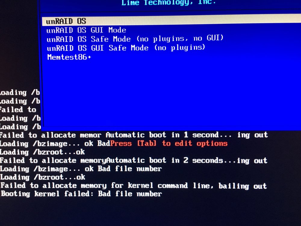

I've plugged a keyboard and monitor in, started the server, got the Supermicro splash screen and then get stuck with a blank screen with a white strip  with "DXE --Legacy Boot Start" across the bottom and a cursor in the middle of the screen that doesn't blink or do anything; I think this might be something to do with IPMI, but I'm not sure as it's not something I've dealt with a great deal.
I've tried booting up into bios to see my options and confirmed boot order, but when I chose either the UEFI usb card or plain vanilla here, I just get a totally blank screen in the process.
Should I remove the usb drive from the server and plug it into an already booted up computer and go in to delete the /boot/config/network.cfg there and then put it back in the server, or will this not work/cause more problems?

So, just to clarify, am I ok to remove the usb drive from the server and plug it into an already booted up computer and go in to delete the /boot/config/network.cfg there and then put it back in the server, or will this not work/cause more problems? Will the network.cfg be recreated on boot after deletion?

I deleted the /boot/config/network.cfg file in another PC, put the usb back in my server and tried to boot it up in both UEFI and Legacy and neither worked. I'm beginning to wonder if the USB drive or mobo are failing. Tomorrow I will download a fresh image of Unraid onto a known working USB drive and put that in the server to see if it works. For testing purposes, if I put the current USB drive into a different device and boot it up, will it change the configs on the drive?
Have you any other suggestions that I might try?
