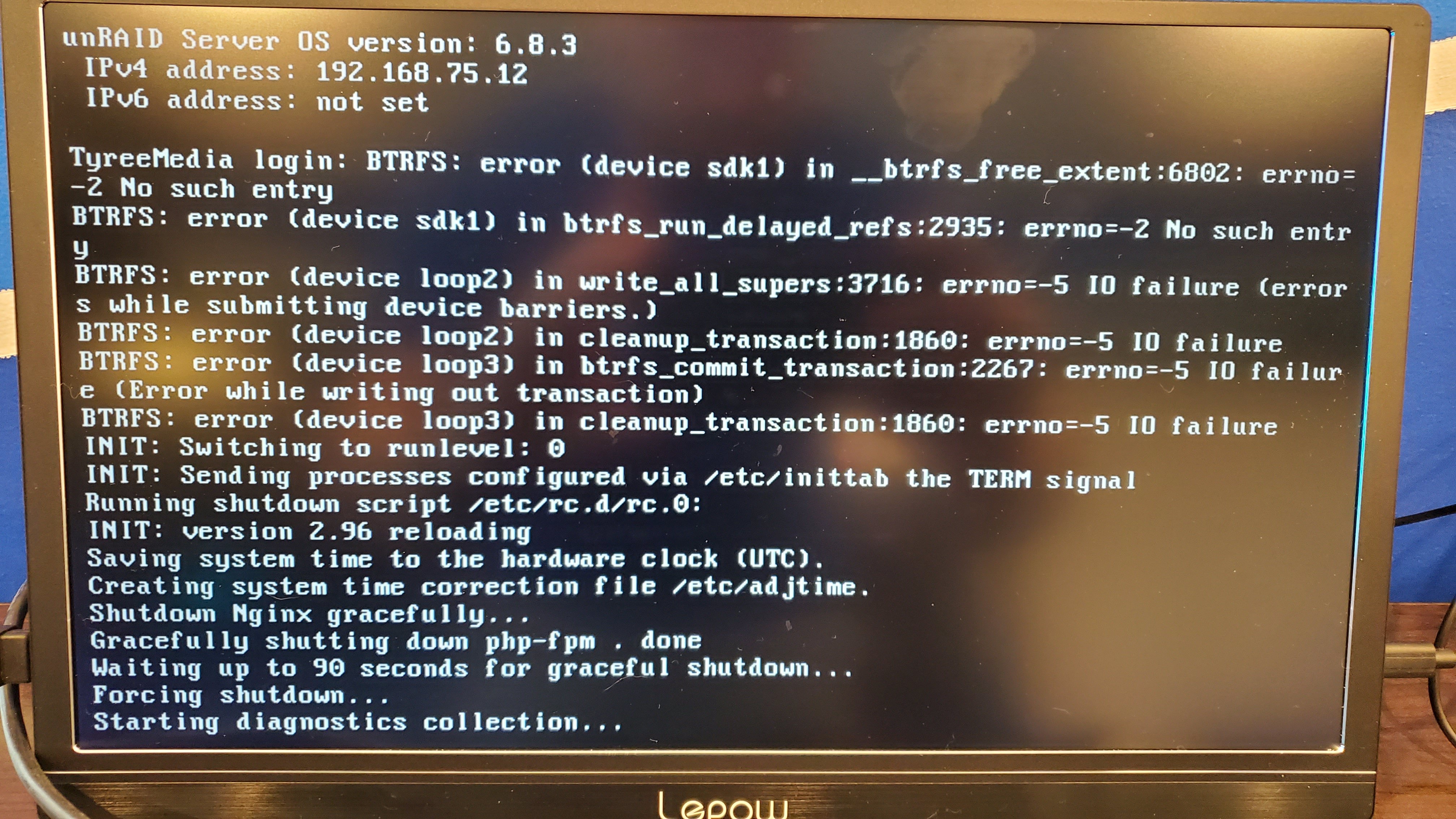

July 12, 20206 yr Need some help. I recently moved Plex from a Windows machine to my unRAID server. As part of that process, I installed unRAID Nvidia so that Plex could use my graphics card. Since then I've had issues with unRAID. First I wasn't able to reboot the server. It would hang on Sync filesystems... I finally hard reset it and it came back up, ran a parity check. I waited for the check to finish, took all day, but parity was good. Went to turn it off to move it back into my server closet and the shutdown went awry. Lots of BTRFS errors and now it's "Starting diagnostics collection." See the image. Can anyone help with this? I'm an unRAID novice, to put it mildly. Any help is appreciated! Thanks! Matt

July 12, 20206 yr Author So, it appears to be a problem with my cache drive which has been running fine. I had to do another hard reboot on it. After trying several USB ports for my boot drive to read as bootable (another problem), it finally cam eup but gave me the BTRFS errors again. IN the WebGUI< I can see that my cache drive reads as "Unmountable: No file system" All my appdata was on there. Is there any way to repair this?
