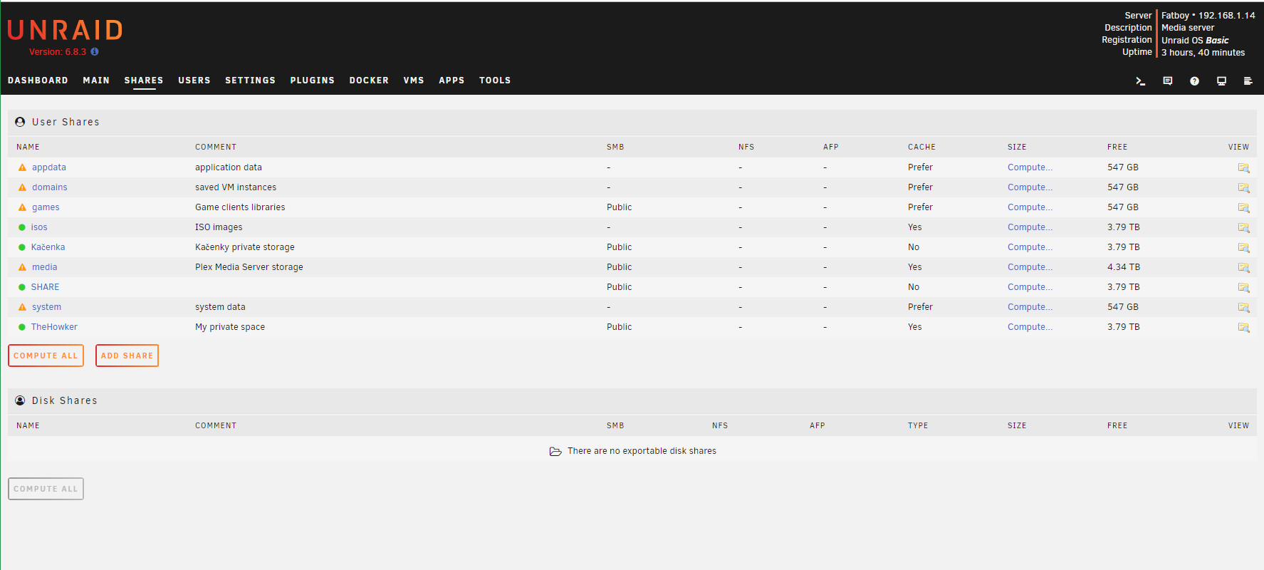

I have 3 shares:
Media(Cache: yes),
my private share(cache: yes),
Games(for game libs, cache: prefer).

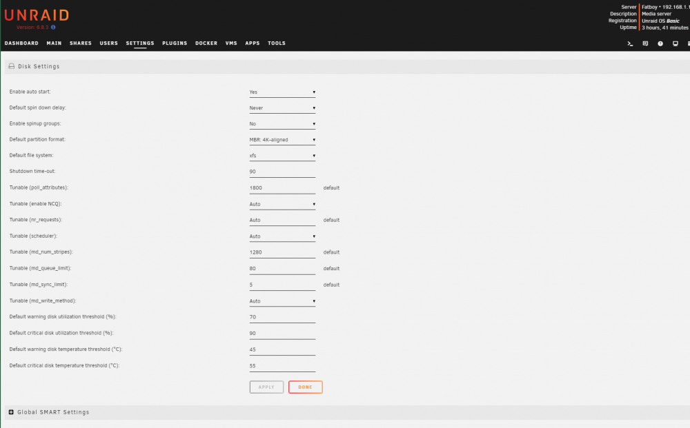

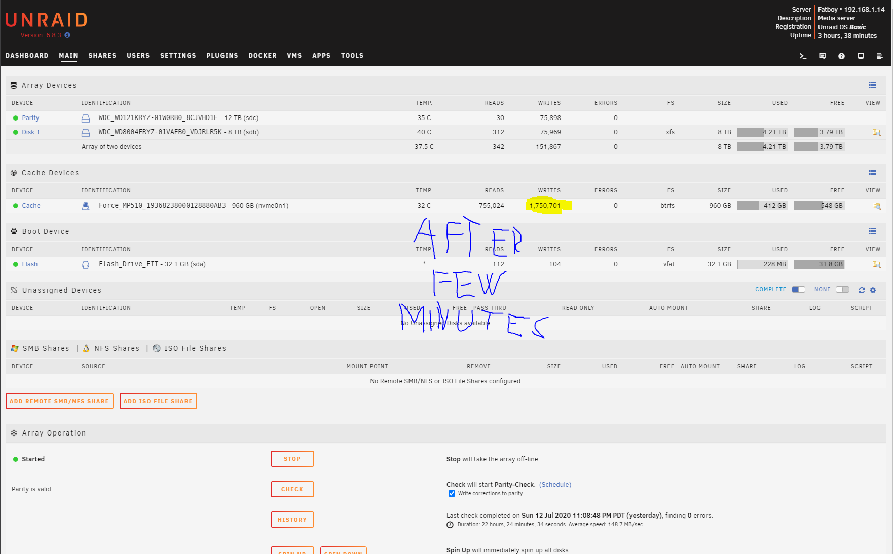

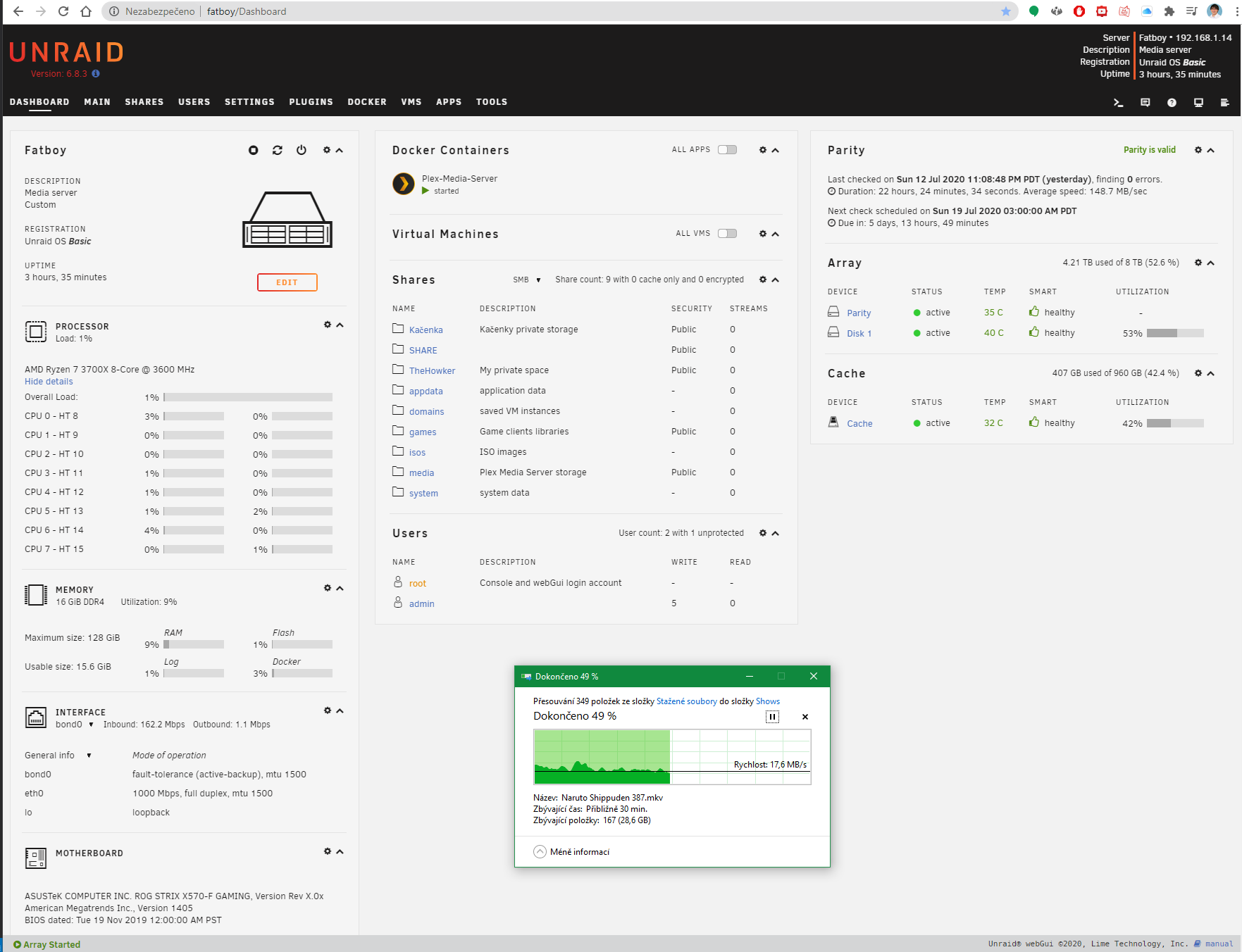

I moved 300GB of games into server than around 5-6TB of media and private files. Everything was fast as expected during 1Gbit limitation (100-120MB/s write speed). Today without any change whatsoever my write speeds are from 10 to 30MB/s. On the forum I found few topics where users talking about "normal speeds" for array with parity, but i have NVMe cache and two days ago it worked perfectly fine. I checked usage of my cache and I have 700GB free space, also during upload I can see all my data are going onto cache first and then they are moved(with scheduled mover), so this also work as expected. I really need your help in this issue. Because it worked fine for first day I really dont know how to fix it.

Thanks for your help, but I already figure it out. I unplug ethernet cable by mistake and was connected with Wi-Fi only on my pc. It's little bit weird, even with Wi-Fi 6 I'm not able to reach 1/3 speed of 1Gbit cable connection, but it was resolved by cable, so everything is working now.
