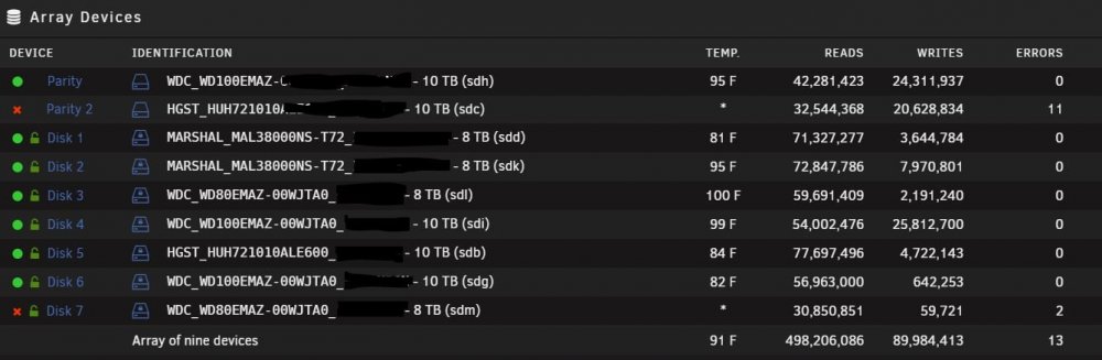

At the same moment, I woke to find that my disk 7 and 2nd parity drives are disabled. I read where if you can remove everything from a drive you can shrink the array without losing parity protection. But in my case I would have to shrink the array by 8TB AND remove the second parity disk. Can I do this or should I simply do a new config and rebuild parity, effectively putting my data at risk until it completes? Any help is appreciated.

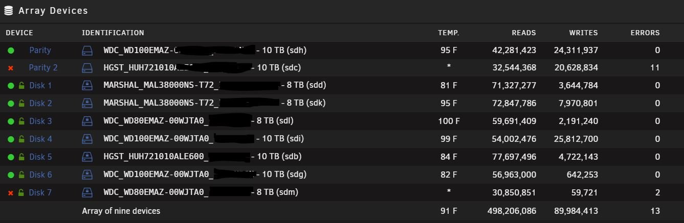

On the unRAID Users & Help Group on facebook, someone mentioned that my power supply could be the cause. That might explain what I saw yesterday morning... attached.
