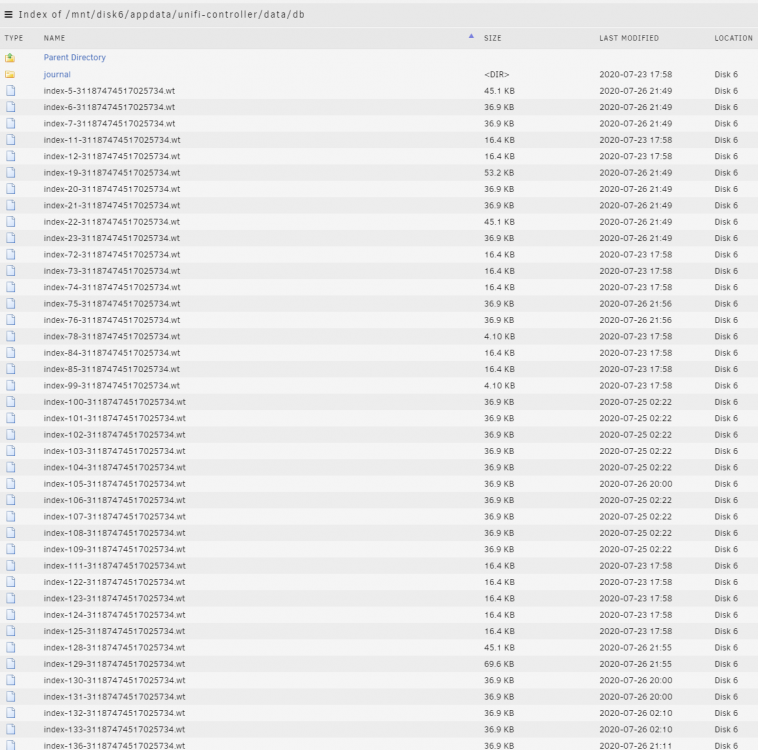

I installed the unifi-controller docker a few days ago and I did not change the cache mode of the "appdata" share. Its still set to "prefer". This means new files should be written directly to the cache drive and should stay there, but there are files on my disk array. How is that possible?
P.S. Some of my plex docker files are on the disk array, too (same appdata folder), so its not only related to this specific docker container.
Prefer allows files that are written to the user share to go to the array if the specified cache pool is below minimum space. IF the files on the array aren't open AND there is space, the mover will put them back on the cache pool.
So, if a file is written to the array and it is open while the mover runs, it will stay on the array even if there is now enough space.
Ah yes. How could I solve this? Because the files will never be moved to the cache as they are in use.
Stop whatever process has the files open, run mover, restart what you stopped.
