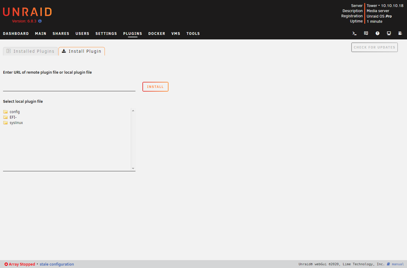

July 27, 20206 yr You should install all plugins and dockers from the Apps page, but to get the Apps page you have to install the Community Applications plugin on the page in your screenshot.
