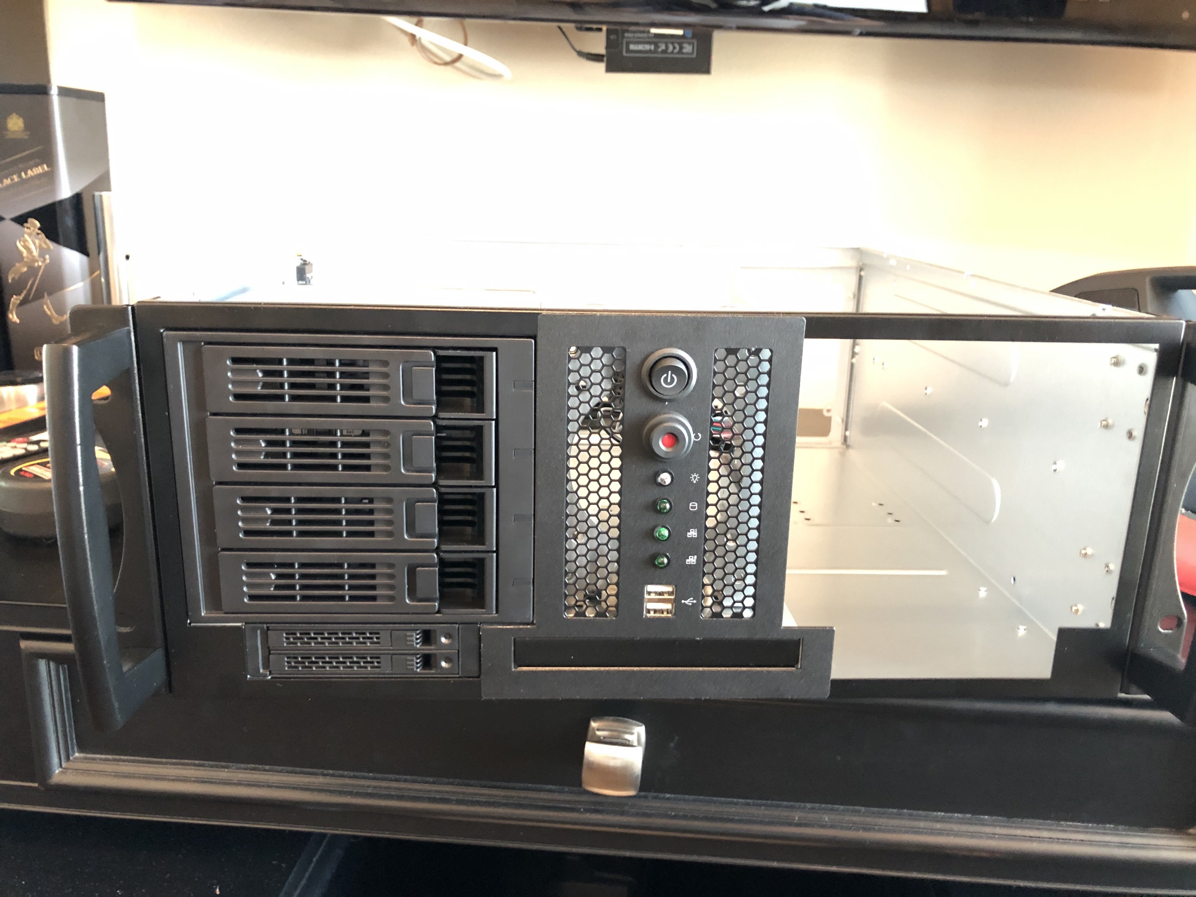

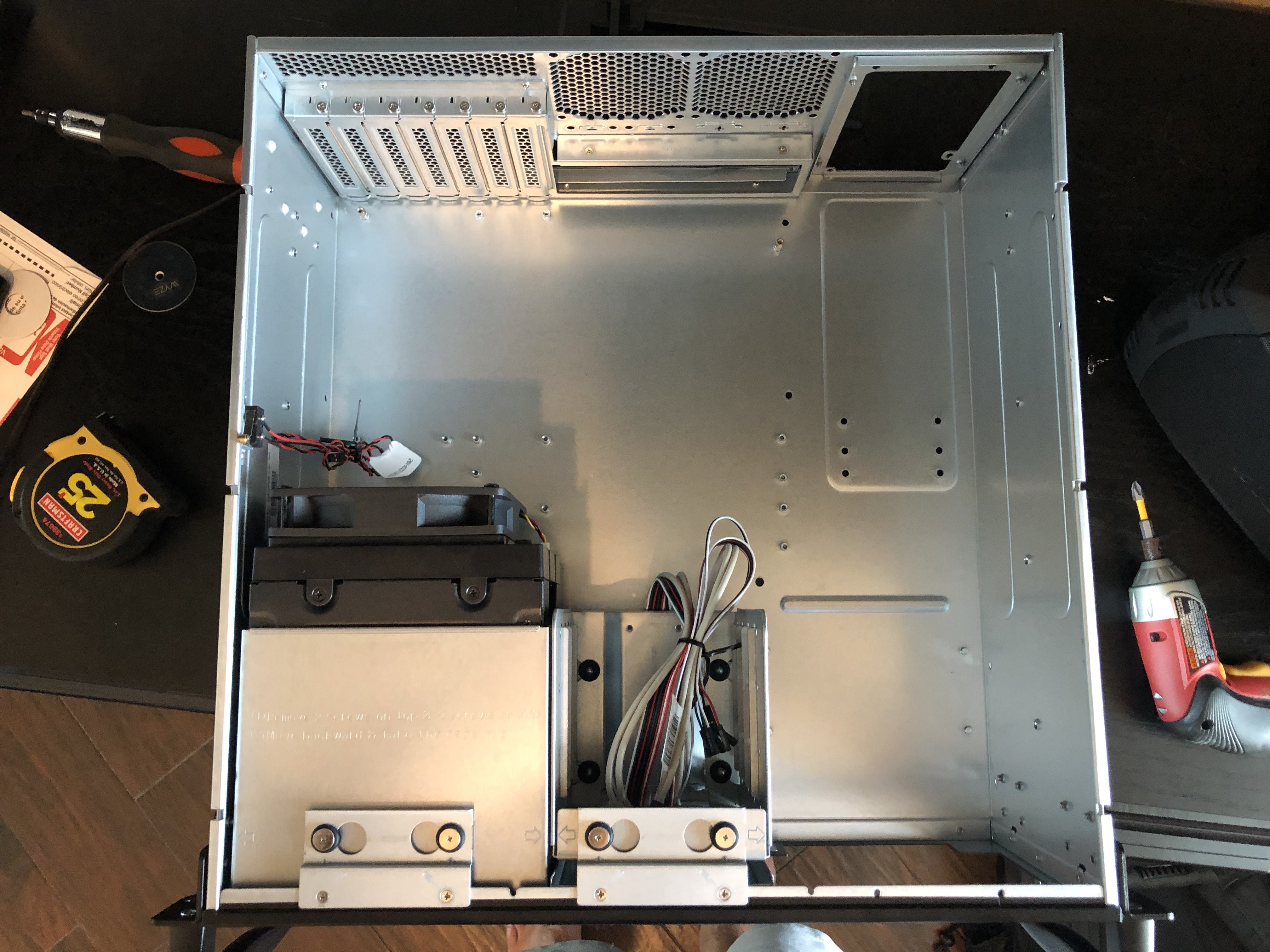

I've got a rack in an vented AV closet but my rack is only 19" deep so I was limited on case options.
I went with the Chenbro Rackmount 4U Server Chassis RM42300-F
I'm going to replace the 5.25 bays (right) and fan (left) with 2 Rosewill 4x3.5 cages.  2nd case bracket is shipping now. Also adding 2 Icy Dock Express Cages for SSDs for VMs
Space will be tight, but I think I can slip the motherboard under the fan at the back of the cages and tuck the power cord under.

Does the NH-D15 Cooler actually fit inside that case?
