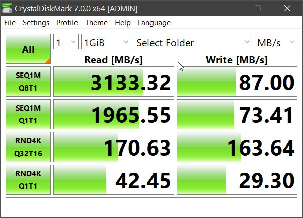

If transfering project folders to an smb share not using the cache (containing video files of 300MB - 1Gb AND smaller After Effects and Photoshop projects 10-40MB) I am seeing around 50-100MB/s). I used Crystal DiskMark to get a benchmark result:

Saying speed of the Sata connection is refering to the speed I got when I tested the HDD with just Bare Metal Windows and the drive not in the array (all before installing unraid and setting it up). I got around 200-230MB/s transfer speeds.
