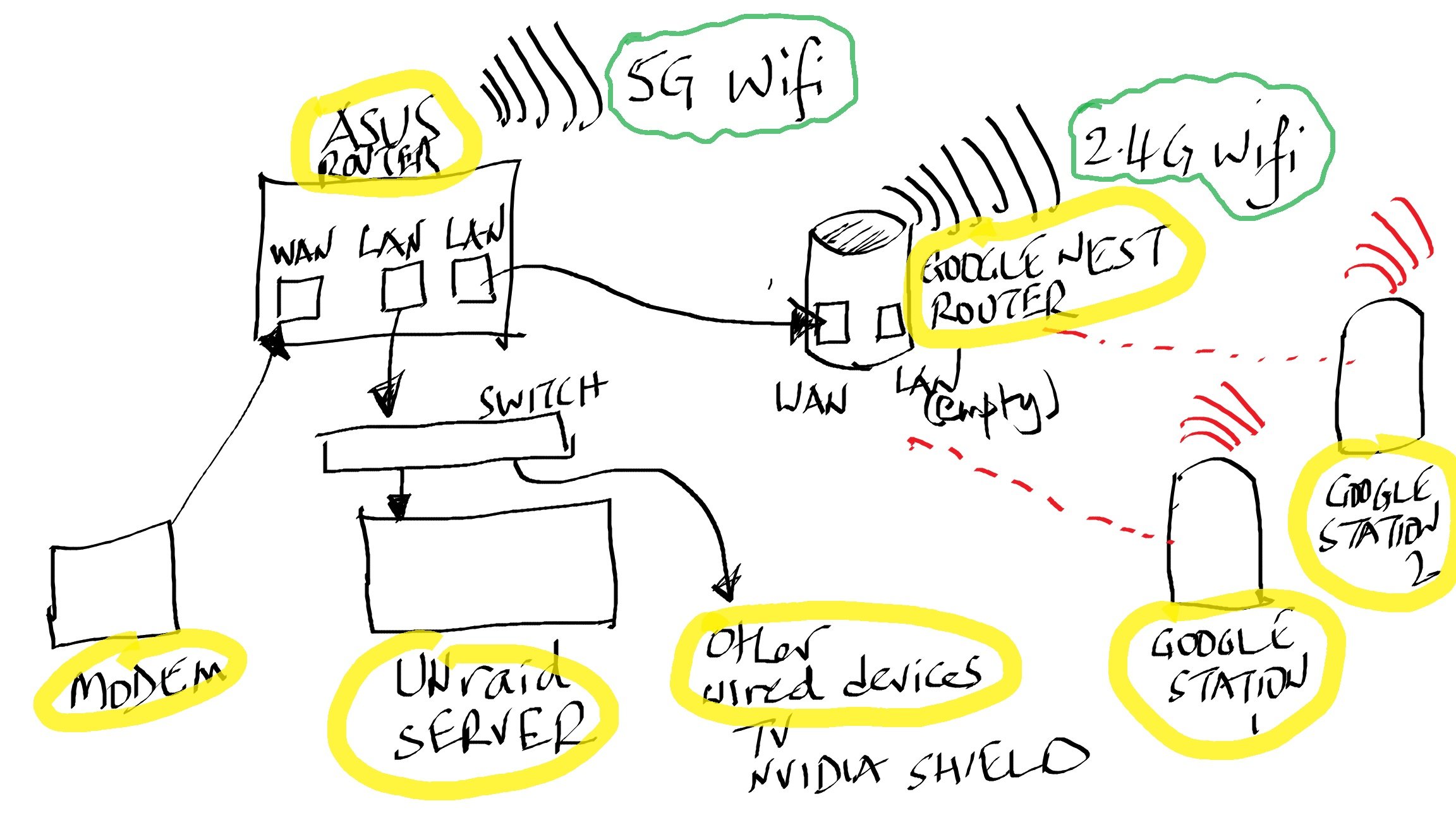

August 12, 20206 yr Love the diagram! I'm not sure if any of this stuff related to Asus routers applies to your case since you're using two different routers on different bands, but it might be worth taking a peek at some of the options to see if anything helps. https://www.cnet.com/forums/discussions/rt-ac87u-why-cant-i-see-my-shared-folders-when-using-5ghz-629156/ Aside from that, if you're able to verify that the Nest 2.4G network does route back to Unraid through the Asus (i.e. the Nest router is acting as an access point to the Asus, rather than it's own independent network), so that basically everything is working despite the speed.. not sure what your problem might be. It would seem that it's a band / compatibility problem between the Nest and the Asus. Since Unraid doesn't do anything with/on/to/for WiFi directly, it's not an Unraid problem specifically.
August 12, 20206 yr Phone can access thr 2.4G usually because it already know/cache the hostname-IP of Unraid when it connect under 5G WiFi. You can try access Unraid by input it's IP. But router should default block any SMB for WAN, otherwise critical security issus could happen. BTW, you shouldn't connect NEST WAN to router, this will under NAT ( network adress translation ), you should connect to Nest LAN, and disable Nest DHCP function ( assign IP function ), only Asus perform IP assignment. Edited August 12, 20206 yr by Benson
