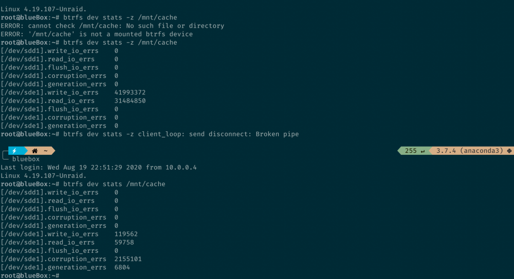

The sde1 drive of the server cache is has write, read, and corruption errors. The HD drive is the secondary drive in a cache pool with an SSD. I've followed the instructions in the FAQ for monitoring btrfs pool. Here are the steps I've taken:
  • Check btrfs stats
    • confirmed errors
  • Check cable connections (same cables)
  • Run btrfs scrub (clicking on cache from main)
While scrub is running I see that there are "uncorrectable errors" on sde1. The drive in question also fails a SMART test. What would you recommend as next steps? is it time to replace the drive and cable?
Background: These errors started happening after replacing a smaller SSD in the cache pool. sde1 was not touched.

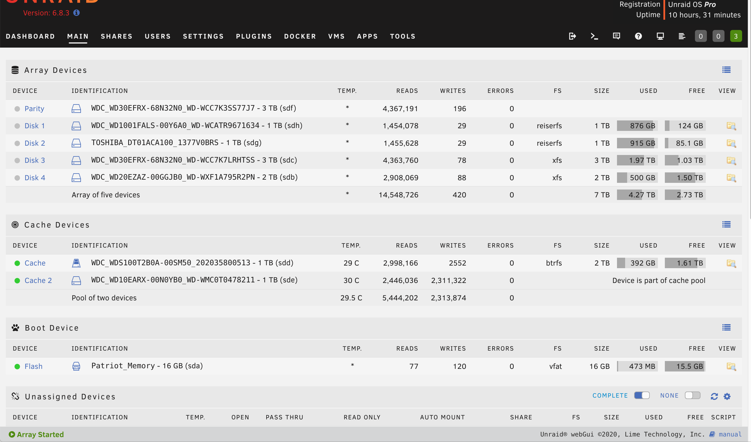

Any drive that fails SMART test should be replaced.
Why would you do this? Why do you think you need 2TB for cache anyway?
There are also some things about how you have dockers / VMs configured and using your shares that I would change. Why do you have 40G docker.img? 20G should be more than enough unless you have something misconfigured.
Personally I would go for replacing SSD cache and not even have another in the pool unless it was another SSD. Since you apparently don't care about redundancy in cache might as well just go with a single SSD.
Since cache appears to be readable and not a lot of used space currently, you might just move it all to the array, create a new SSD only cache with new SSD(s), and then work on getting those things moved back to cache that belong there. Currently your domain and system shares have files on the array anyway so that could use some work as well as recreating docker.img at a more reasonable size.

You should backup and recreate with the single SSD.
Thanks for the quick responses. I will backup and recreate the cache pool with another SSD. I believe I understand how to do this but to be doubly sure, I don't make a mess of things again, are the steps documented in the FAQ or on the wiki?
I had an extra 1TB hdd drive laying around that matched the size of the 1TB ssd that I recently purchased and thought it would be better to make a pool for redundancy than using a single drive.
As indicated at https://wiki.unraid.net/UnRAID_Manual_6#Creating_a_Cache_Pool - "Pooling multiple storage devices together ensures that data protection is maintained at all times, whether data is in the cache or the array"
I bought a 1TB ssd because the previou 250GB ssd was regularly over 75% usage and there was a discount.
Pairing HDD with SSD sort of defeats the purpose of having SSD since it will only work at HDD speed. And if redundancy is what you had in mind you apparently didn't accomplish it as shown by johnnie.black. I assumed you were just combining capacity so no redundancy since that is what your screenshot showed.
You also need to consider getting those ReiserFS disks converted.
